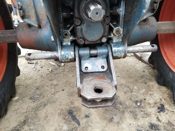

I just bought a b7000 with the tiller attachment. I would like to take it off and make it a 3 point hitch but don't know what size swing arms to get or where. This is my first tractor. I'm not sure on what type of transmission oil to use either. It has a front end loader as well that runs off the transmission oil. Thanks
33,000
8,453
You will need to find the lower arms and mount off of a B7100, B6100.
I don't think you will even have the pivot point that you need.
You need to post a picture of the rear lower section for us to tell more.
The fluid is easy, any hydraulic fluid that is UDT compliant will work perfectly.
Since it's a grey market tractor , you can look at the main pages of the forum and get the filter numbers, looks like all the filters are the same as a B7100.

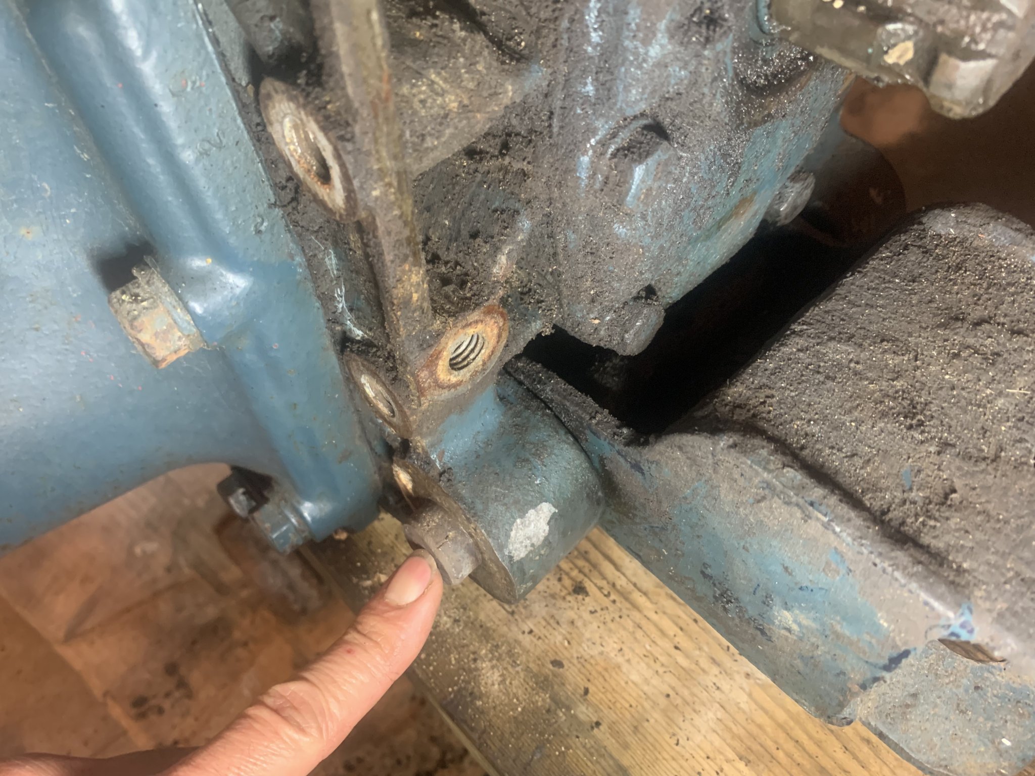

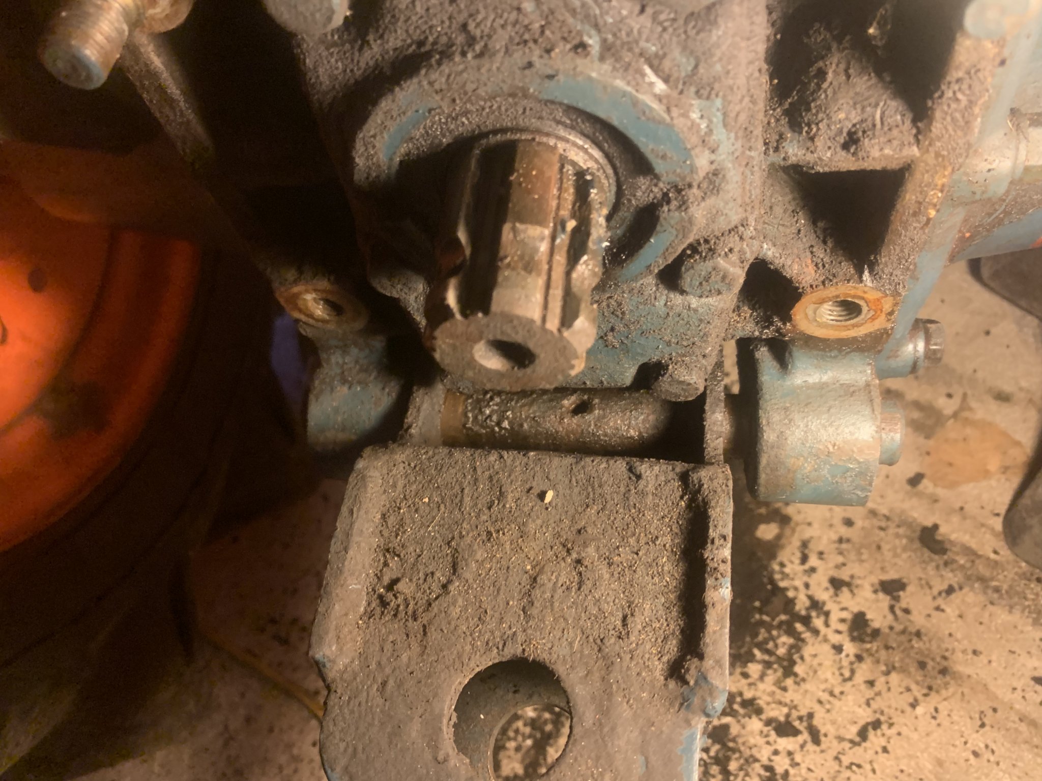

I am in the process of converting my B7000 to a 3 pt hitch as well but I a, having trouble taking the original pivot point off. How did you get yours off? 92F14B9A-FBBC-4221-ADC4-13587B746B0F.jpeg 5C882B81-A046-48CA-A0DD-538DF3CA905F.jpeg
I’ve tried hammering, lots of penetrating oil and heat but the bloody thing will not budge!

I am in the process of converting my B7000 to a 3 pt hitch as well but I a, having trouble taking the original pivot point off. How did you get yours off? View attachment 59779 View attachment 59780
On mine, that hitch has a bolt with locknut on the bottom side that must be loosened before the bar will slide out. The bolt sits in a recess in the bar to keep it centered.

Thanks Lil Foot. I did remove that bolt. Turns out the pivot was seized and needed to be heated to be persuaded to leave its home for the last 40+ years 😤.
