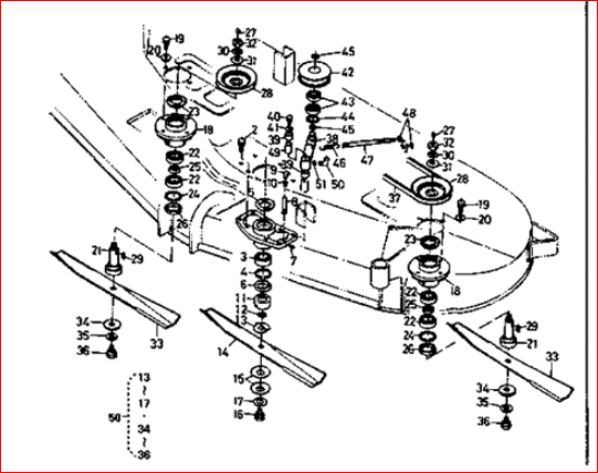

@85Hokie thanks! do they have a workshop manual for the deck RC48-62H? If so, could you send the link? Thanks!
Dont see a freebie on that ........... but Messicks will have the part breakdown if needed.
