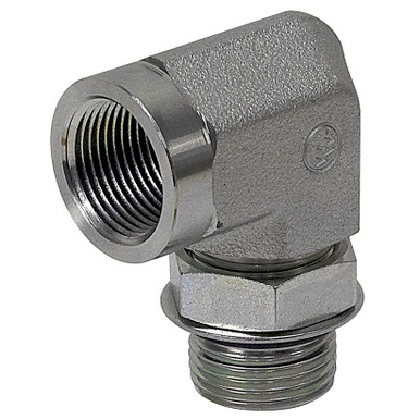

The Kubota cylinders are plain welded cross tube cylinders.This is an aftermarket 18 stroke cylinder that will work just fine on the boom. . The bucket cylinders are identicak but have a 16" stroke. I replaced all four on my loader years ago. You woukd need ORB to NPT elbow adapters for the hose connections.
