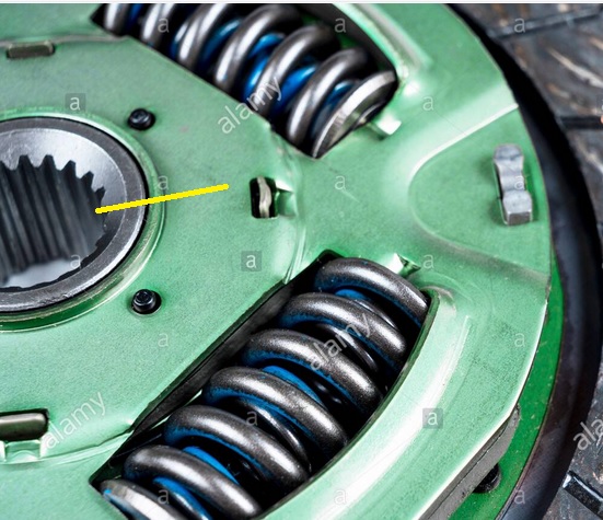

Thinking of the failed fork you reported, I wonder if the disk is sliding freely on the splines which lock the clutch disk to the transmission shaft

Thanks Dave. Are you referring to the clutch throw out bearing? That is well greased and moving freely I believe.
No he means, he's wondering if the clutch disk hub is binding on the propeller shaft, Like there is a worn notch in the shaft, that will make it bind.
