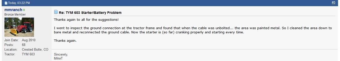

Replace the battery cables too! Also clean the place on the frame where the ground cable is attached.
There have been many poor cranking complaints on this forum and when we ask for a photo of the top of the battery.
