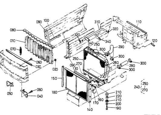

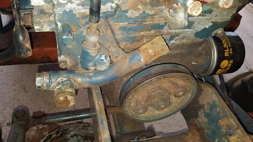

The hose to my water pump failed so am flushing radiator and replacing all coolant hoses. I cant find the part number to the lower hose from radiator to water pump.
The hose I need fits from lower radiator to metal water pump pipe which is a variant to the one in Water pump section of parts manual, in box noted "CA" see picture from parts catalogue.

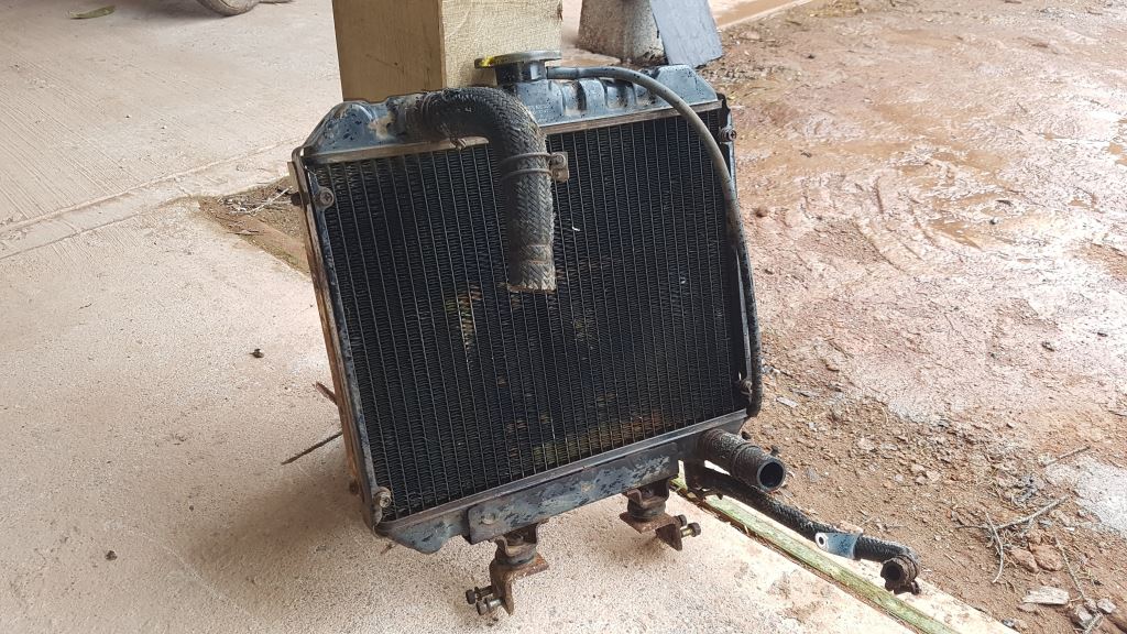

The hose I need replaces P/N 15751-72850 But its a shorter straight hose see picture of radiator. (Bottom right)

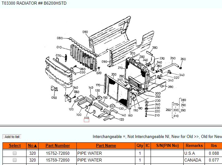

Ahh OK.
I've been looking at the parts manual for B6200D.
I cant find parts manual for B6200HSTD in the index of Kubotabooks parts manuals.
Do you have a link?
I presume the part numbers for the other hoses are as that in B6200D parts book?

I got a bit confused here. It appears I do have the B6200D not the HSTD.
However the water hose for the HSTD look like the right one.

Wolfman, do you think he has a Canadian 6200D? If you notice in the first attachment he sent there is a little "CA" which I think means it's specific to machines sold in Canada, eh?
Groose
B6200D
Jun 12, 2015
Bridgwater UK
Its a gear shift.
I have since discovered the hose part i need is Canadian version. Both US and Canadian versions available in the UK and probably the same part but happily the Canadian version is half the price.
