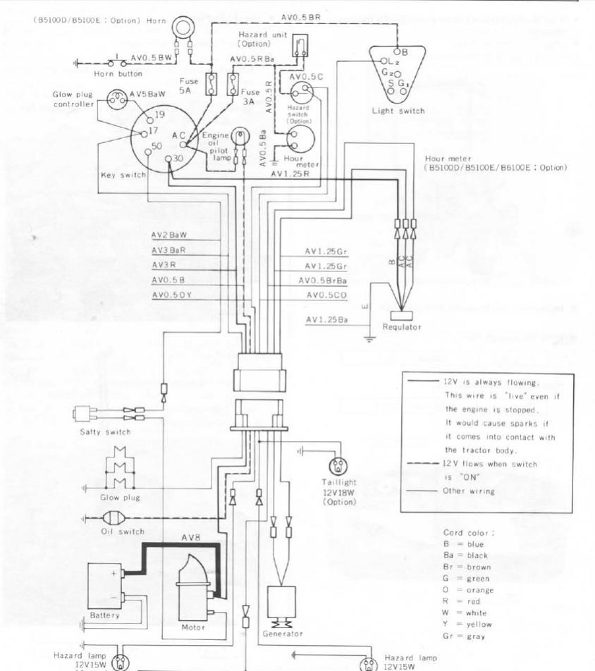

Looking at this wiring diagram (this is NOT for the B6200 - rather the 5100,6100,and 7100 tractors) I would trace the wires from the starter motor if yours is similar to where this comes to the key switch - #30......this is where all the electrical gets the power to run in THIS situation.Then see if your Key switch has the AC out on the back of it - this is also where power is supplied to your lights - etc. Test for 12+ volts here
YOUR lights/flashers should work without the tractor running - just turning the key to the on position.
SOMEWHERE a wire has vibrated off, got cut or ........something, it might be a PITA to find, then again maybe not. Check all your fuses too with an ohm meter then trace the wires back to the battery - key switch and report back what you find!
Could be a bad key switch, or broken wire or ........

Well didn't have long to look at it before the wifey poo came home and we went out to dinner. Couldn't get the steering wheel off to gain easy access to the electrical. I was able to move it around enough to see that the wiring had been butchered long ago and probably by many different people. Got the ignition switch out but didn't notice any wires that look like they recently fell off. Nothing obvious anyways. There are unused wires but look like they haven't been used in quite some time. Glow plug indicator has one wire off and I found a plunger switch just hanging out in there and have no idea what it does but there is power to it.
The tractor does turn over and start so it's gotta be something fairly simple but I'm going to have to wait till I can get perhaps a 3 jaw puller to get the steering wheel off and a time where it's semi warm and when I'm not going to need the tractor the next day. Guess for the time being ill have to drive to and from the sugar shack by feel in the dark. For now there are only snow banks I'm going to run into.
