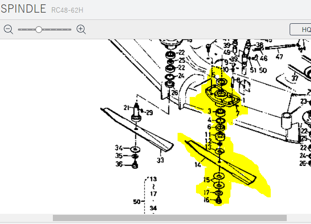

Hi, Folks: I have an old RC48-62H mower deck associated with an old B6200 HST tractor - Great product - Never let me down for 36 years. I now have a gear box leak that needs to be addressed. I've removed the center blade and four mounting bolts on the belt side of the deck, and hoped that the unit would then lift out. I assume there must be a keyway or some other mounting feature that helps hold the gear box in place. Do I need to also take the underside plate, bearings, etc. off in order to release the gear box? Please tell me what I need to do to free the unit from the deck. Thanks, Jim

You need to remove all of this from under the deck, then the gear box should come out.

There is a snap ring on the bottom side of the deck on the shaft that needs to be removed in order to free the shaft from the spindle housing. I have the same deck for my B7200. I will say I was chasing down a leak myself at the end of the mowing season and it turned out to be a worn out gearbox. Examine the inner diameter of the box wear the bearings seat to make sure it isn't rounded out. This will cause the shaft to wobble and the seal cannot seal properly.

Thanks to you also, N38P, for taking the time to post and for sharing your expertise. I'll definitely check the gearbox condition. Jim
