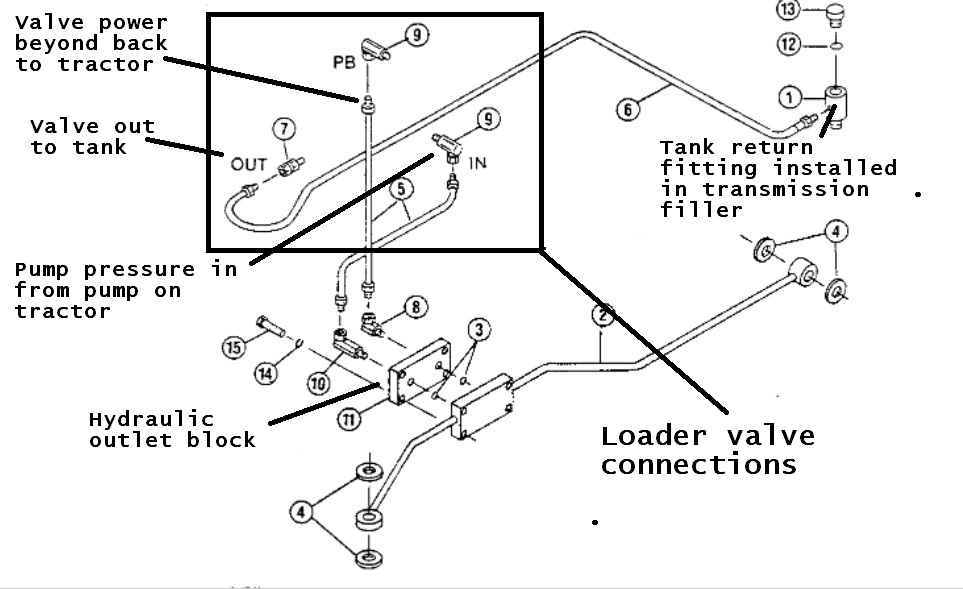

That is probably top of the FAQ list. Yes it has been done and is inexpensive and easy. Here is the factory loader valve plumbing. You will need the hydraulic outlet block to split off pressure to the loader valve and return it back to the tractor for the 3pt lift. That can be purchased form members here. The transmission return fitting is stil available from Kubota. The rest is generic hoses and fittings you can get anywhere.

No need for apologies and here it is in a nutshell. I am going to skip the longwinded and confusing details of how and why for now and focus strictly on connecting things.
Your current loader valve probably has four hoses to the cylinders and two hoses connecting it to the pump. The four hoses going to the cylinders are fine. Its those two hoses to the pump that we need to talk about. One is a high pressure in from the pump and the other is a low pressure oil return to the hydraulic reservoir (tank) in the loader.
To use the hydraulic system on the tractor you need a loader valve with three supply hoses, One is high pressure in from the pump, one is return oil to the hydraulic reservoir (tank) in the tractor, and the third is a high pressure return to the 3pt lift valve in the tractor. That third line is commonly called power beyond (PB) or more correctly high pressure carry over (HPCO).
Your current loader valve may or may not be capable of providing that third connection. If you can find a make and model number on it that might be helpful, Some pictures of the top and sides where the hoses connect might also be informative. In any event it is not a game changer - a replacement valve is not horribly expensive at roughly $150.

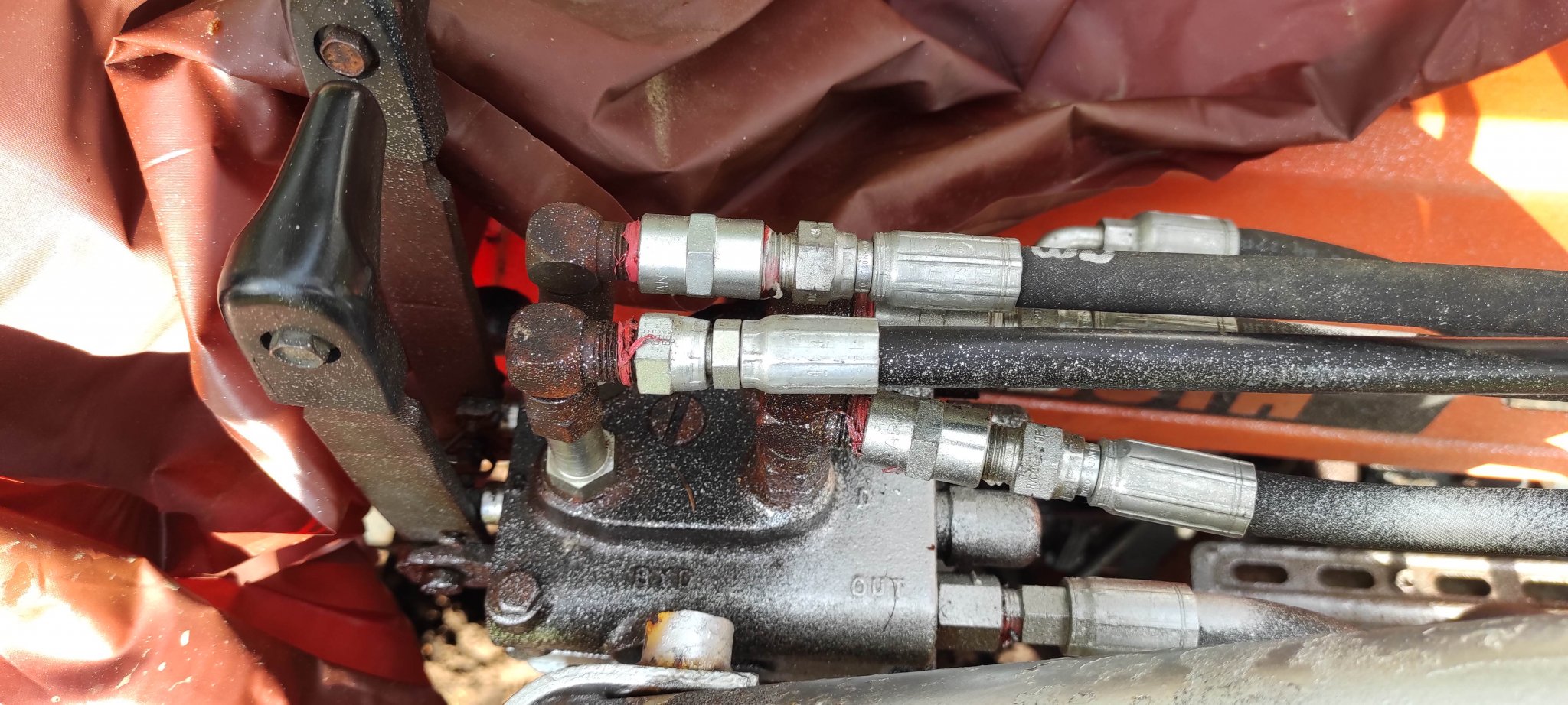

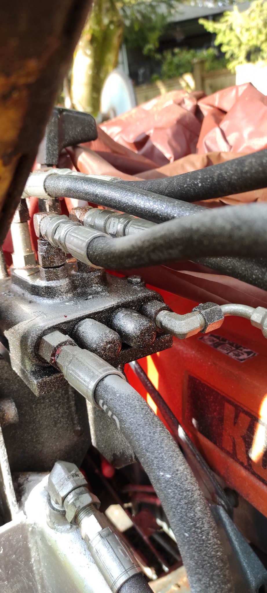

I think that I may need a new valve. I could not find a plate on the valve, so I snapped a few quick pictures. I don't believe this has the power beyond feature, but can the experts please weigh in?
The high pressure from the pump is the one on the bottom right of the front, and the low pressure return to reservoir is the bottom left.
However there are two capped outs that are directly in front of the two valve levers. Could these be power beyond outs that are capped and not in use in this setup?

Can't tell for sure but looks like no PB and no inlet pressure relief. You really need both.
