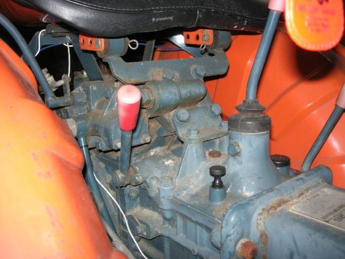

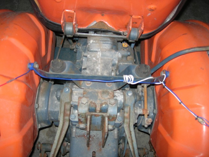

Here's a couple shots of the seat on my B6000E, maybe it will help. I'm going to say that for some reason the manual looks nothing like the parts used on the on my B6000E. The story with this tractor is that the man who bought it new in 1974 handed it down to his son, who in turn sold to the prior owner 10 years ago. I have only one recipt to document the prior sale to the guy I bought it from. End of the story is I have no idea if this is an original seat. The dry rot on the stearing wheel and rust hood make me believe this is a recovered original or a replacement from an other machine. I hope all this helps.
Good luck with your project.

Thanks Dusty and Rust Addict for the help on my seat brace questions. I'm beginning to think Kubota doesn't have a very good grip on configuration management! The page out of the parts break down that Rust Addict shows looks very much like my tractor, with the item 10 rubber block. My dealer said my tractor must have had a "backhoe kit" on it at one time, which was what the #10 rubber block went with. However, the Kubota B6000 Illustrated Parts List I bought from my dealer, and the digital parts breakdown he uses, show a seat brace like your picture shows! By the way, the seat in the picture looks just like the one for a B6100 my dealer showed me. The seat for mine only has single "rails" (on the outside) that are pinned to the rubber bushings, where the B6100 seat he showed me had inside and outside "rails". My dealer said the seat brace is supposed to extend to the fenders (to keep them from "flapping"). My plan is to make a seat brace like that shown in your picture. I've already purchased the "rubber bumpers" and although my fenders currently have no holes to bolt the brace to, I'll just drill some. It seems like it will make a much sturdier set up.
Thanks again for the help.

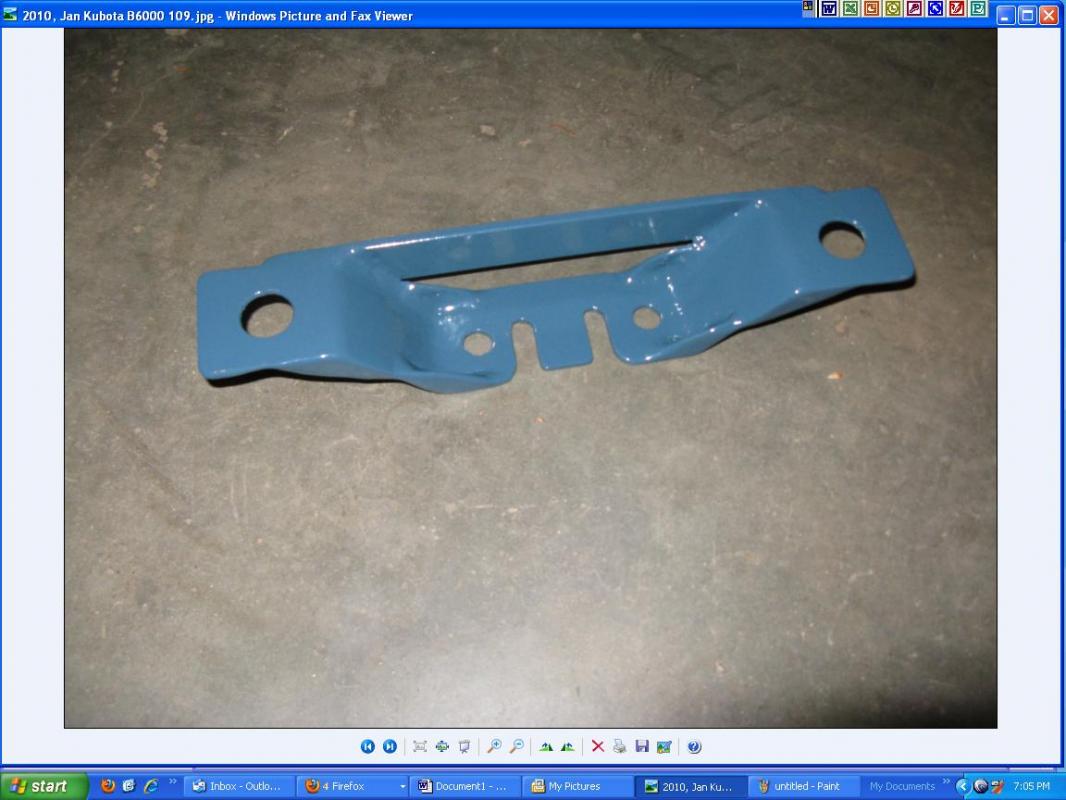

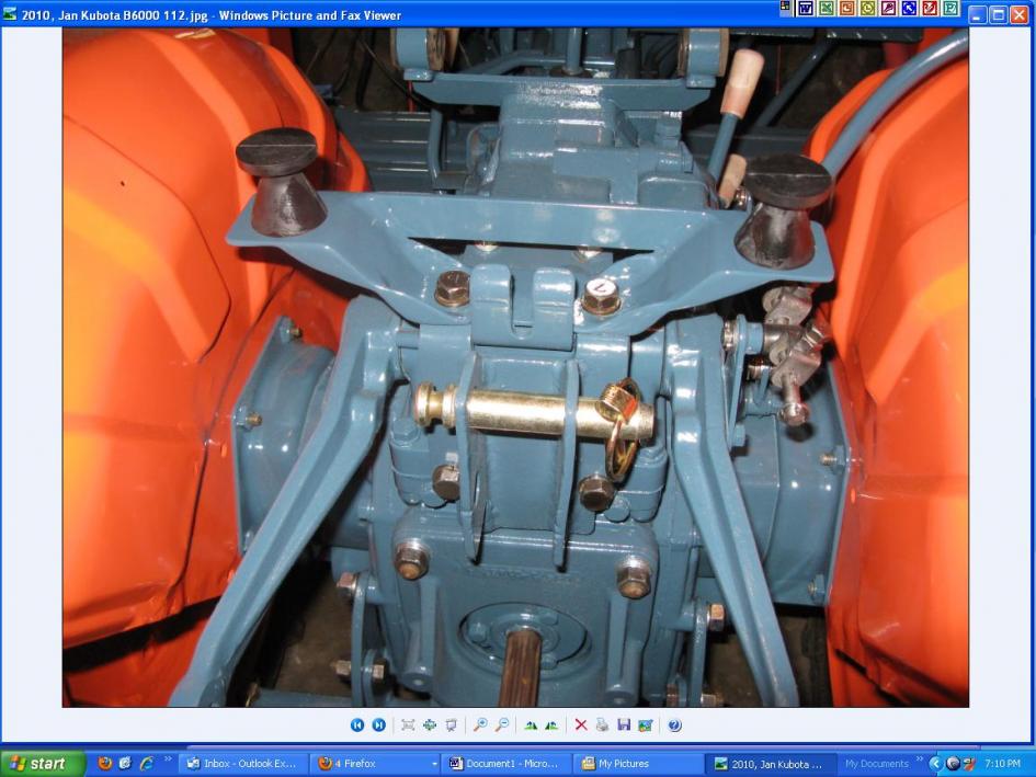

I am way overdue posting to all you helpful folks on what I did for a seat brace. Progress here is slow, but at least I should be grateful there is some progress. I decided against bracing out to the fenders; I can always add that later if needed. At least now I can sit on the tractor, even if there is still a lot of work to be done! Thanks

That's first class work.
Just need to extend it out a bit for a roll bar to mount up to it, then add some work lights, grab handles, and a chain box.
There's always more to do. :D

Thats a real nice job,the photo posted of the original looks the same as the one on my B7100 and I kind of thought the extensions to the mud guards were duel purpose,to act as support to stop the tops of them flapping like elephant ears as well as a bit extra for the seat:)
