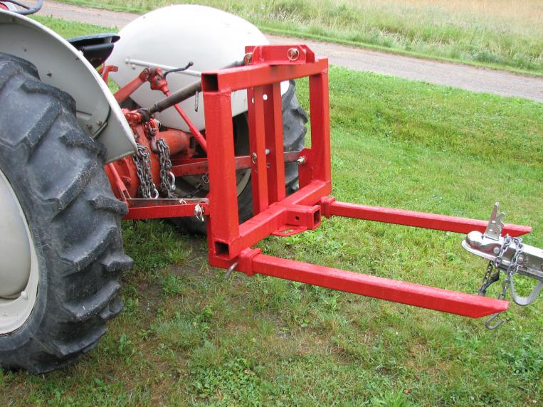

Look at the photos posted above posted by Piker. Only one of his photos show pulling from a low (but not the lowest) point. Most show a chain attached from well above the rear axle, pointing in a direction well above the rear axle.

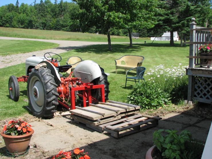

I have 2 cast iron tractor weights attached to my front bumper/hitch & using my 3 point skidding attachment I have never had the front end attempt to lift - not once! Being able to lift a log even slightly (keeping tow point as low as possible), makes a world of difference by keeping the log from digging in. I cut, skidded, chunked up, trucked home (Ranger 4x4 & trailer) & split 10 cord of mostly Maple that winter in a 2 week period. A little common sense goes a long way. I have built a 5' rear blade & gardening implements that attach to my 3 point skidding/trailer hitch attachment - like a sleeve hitch I guess. I also have a Super Split wood splitter & an outlawed Bark Buster cone-type splitter - both work great. I guess I live on the edge in the eyes of the safety police that lurk on these tractor forums.

Piker: No problem with you. You know that you need more clockwise twist to overcome the counter clockwise twists of the tractor power and the load. A front bucket or front weights help. Your hauling with a lift also gives more traction than the drawbar haul.
However, here comes a new comer and they see your pictures with the load being lifted and the effect that has, but may figure it is as safe as possible. Well, giving tips to new comers we have to be careful to explain everything.

Cerlawson: I hear ya. Accidents can happen in a heartbeat, especially if someone is unfamiliar with the equipment. I find my old 1980 B7100 (gear model) to be very predictable, maybe being 4x4 & having the extra weight of the front differential/axel. My 1947 Ford 8N - not so much. 800 lbs. or so on the 3 point fork lift/carry-all I built will bring the front wheels off the ground in a heartbeat. Same for the 6 ft. Ferguson disc I resurrected. I haven't skidded logs with it but my uncle used his every winter for years. I just horse traded for a 36" length of railroad track to incorporate into my front bumper/hitch, to be fabbed up when we move back to the cottage in the Spring. 011.jpg 014a.jpg 007.jpg

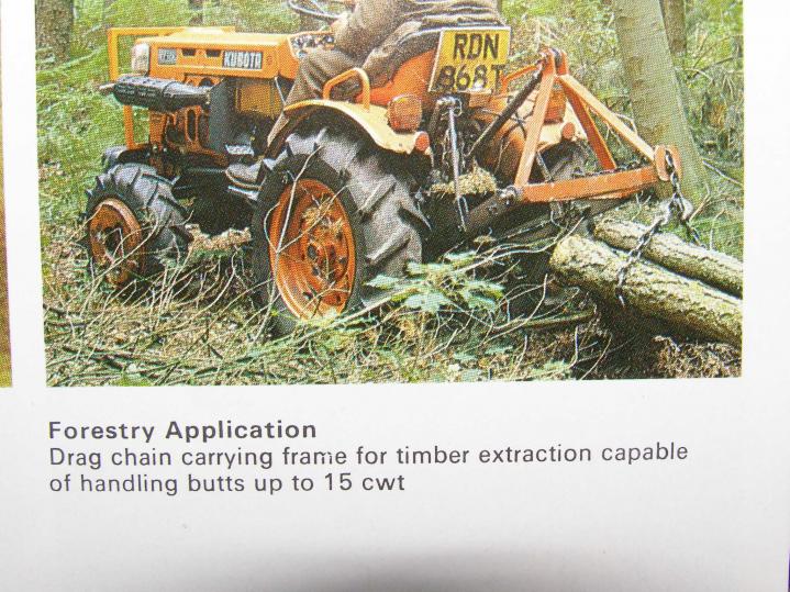

Have to agree with regards to taking extra care etc when skidding, it only takes a split second to flip over.
I dragged a lot of timber around with our B6000, they are very capable but you need to keep within the lifting capabilties.
Golden rules to newbies is allway keep weight as low as possible on the back end, use plenty of front end counter weight , dont over do it.
Skidding timber is a very common usage for small compacts, i have attached a pic from an official kubota accessories book, shows a B7100 with a recommeded kubota skidding frame, Take note of the recommeded weight to be used with it, a b6000 has a lower capacity lifting rating , just keepthis in mind.;)
(You can clearly see in the pic that the b7100 has front wheel weights and front suitcase weights.)
hope it all goes well.
