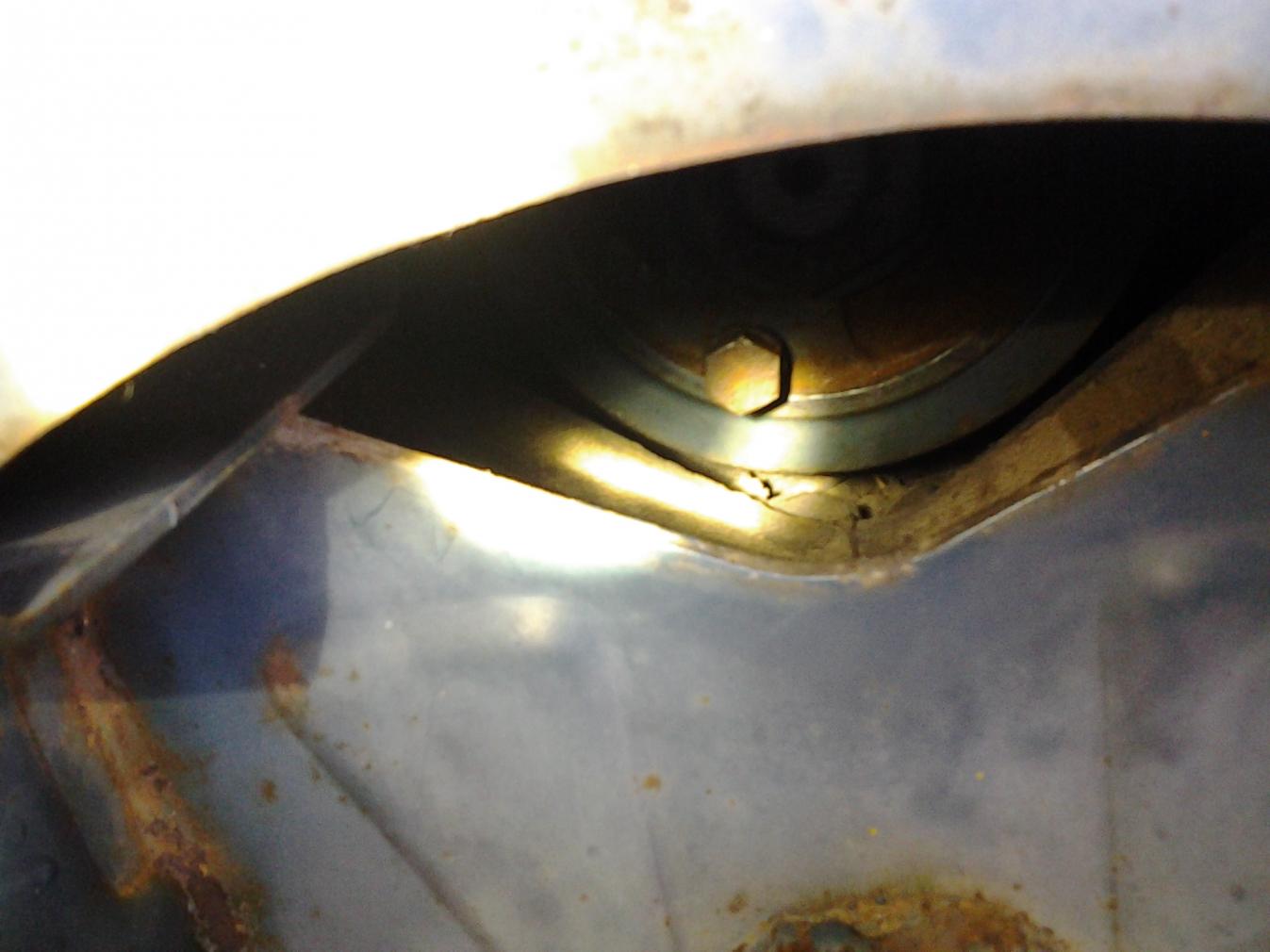

I'm sure this is a "well, duh" question for everyone here but me, but how do I replace the fan belt on my B6000E? It looks like there isn't enough clearance between the crankshaft pulley and the frame to get it out. Of course, I could just cut it and slide it off, but that leaves me with wondering how to get the new one on. Please tell me I don't have to take off the front axle and frame assembly just to change a belt.

On mine (z751a motor), you pull the belt gaurd on the alternator side of the motor. Loosen the alternator, then work the old belt off the pulleys. Spin the fan working the belt around the fins one at a time till it's free, then remove. To reinstall, you reverse the process. It's tight, so be careful not to ding the fins on the radiator.
Course, the easiest way to remove the old belt, is just to cut it :D

Anyone have a user manual? I have a shop repair manual and a parts manual, but I'm sure belt replacement is described in the user manual which, of course, I do not have.
I also suspect that when my tractor was new, there was enough clearance. I haven't looked at it too closely, but I'm guessing the engine mounts may have compressed a bit since 1977, leaving too little clearance between the crankshaft pulley and frame. Just a thought...

I finally got the new belt on. I'm not sure if the way I did it is how it is supposed to be done, but it worked. I ended up putting a jack under the lip where the engine meets the transmission. Then I removed the hood and all but the 2 rearmost bolts that secure the frame to the engine. After giving the jack a few pumps, I could see enough clearance between the crankshaft pulley and the frame to get the belt off the pulley. Next, I removed the fan shroud and I was able to work the belt around and off the fan. Then, just assembled everything in reverse order. Hopefully I won't have replace the belt again for at least another decade :eek:.
