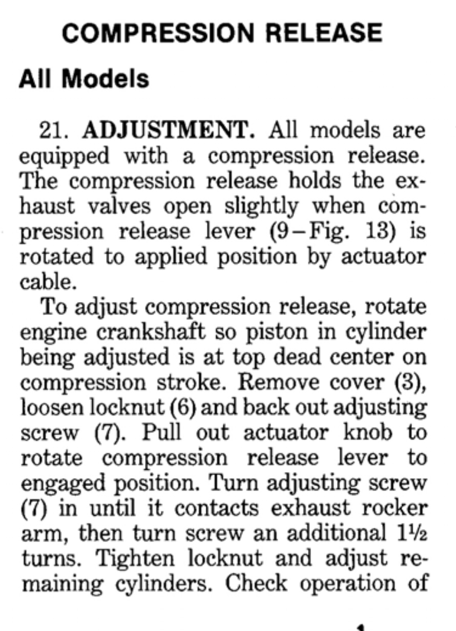

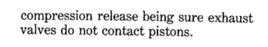

Thanks, so adjusting by the stem and locking of setting by the jam nut.
Problem is to know when the setting is correct, as there is no access port on valve cover to input feelergauge between rocker and the decomp system.
The B6000 service manual is really unhelpful with this, as this is only reference to the system I found:
