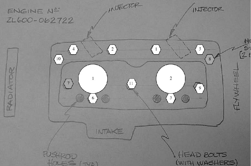

You guys are a great help. I went out this evening to double check, but my motor definitely has 11 head bolts (9 bolts and two studs), all with washers ( motor number ZL600-062722). The Service Manual I got from my Kubota dealer for the B6000 states the following on page 12, sub-paragraph entitled "Tightening of cylinder head" :
"The tightening torque of the cylinder head nut is 6~6.5 kg-m. Only two of the eleven bolts used are stud bolts. - - - "
I went out and took a picture of the tractor's head with the rocker cover off, oriented per Vic (e.g radiator on the left and flywheel on the right) and I also made up a sketch. I know I should have done as Trail Dust encouraged, and tried his instructions right away, but I didn't. Tomorrow I will give it a go and try to post both the picture and sketch of the tractor head.
Thanks

Here is the sketch I made of the head bolts on my ZL600 (#062722). Hope this helps.
Hi GpaG, It looks great! Seems like your getting the hang of screen prints, extremely handy computer tool.
And that sketch you did, very impressive!

Am I the only one that came up short on that post by Vic on 2/18?
Maybe can you run through this one more time using a numbered diagram? I've attached one that sort goes off what your list says, if we could only add up to the same number of bolts. Locations 7 & 8 were noted as studs, not head bolts.
Also, any idea if the head bolts and head studs require the same torque values?
