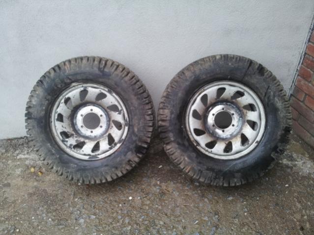

Mean Jean's idea is really neat.So I went with it.I drilled a plate and welded it onto a 15" rim.Rolled on my lawn tyres ,just need some orange pain now.total cost 15 euro well chuffed. tnx mean jean
My other option was to use a set of Nissan Navarra's alloy wheel,the pcd is almost the same...I got my hands on one, waiting on a second at a reasonable price.
