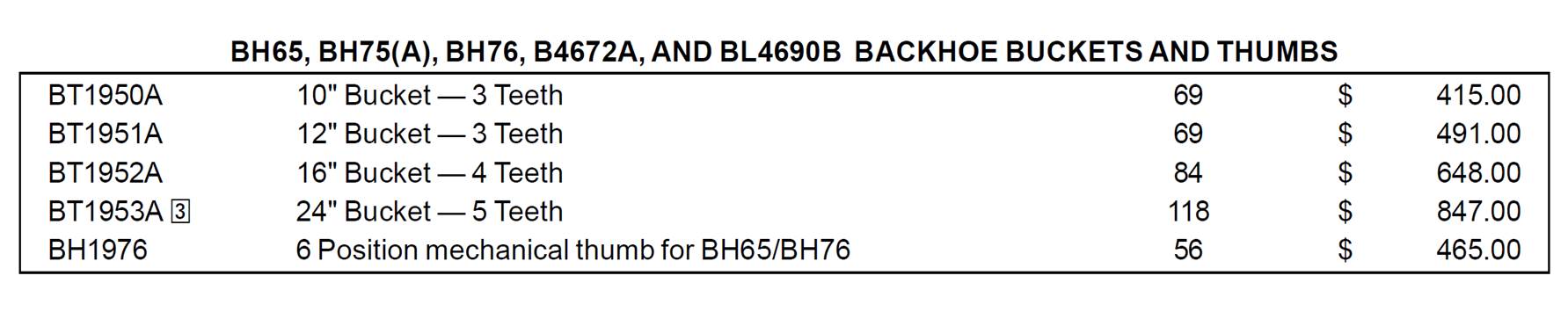

Does anybody have a 8" bucket for sale for a B4690 backhoe or have any info on what buckets will fit this backhoe? The 4672 /4690 manual has no part numbers or info on buckets. I have a 12" bucket but could use something smaller just for 4" drain pipe. Thanks in advance for your help.

From what I can tell, the narrowest bucket for that backhoe is the BT1950A. 10" wide. Part number 75590-42101.
I believe your 12" is the BT1951. I have the 16" BT1952.

Thanks for the offer. I just dug for about 250' of drain pipe and used the 12" bucket and it worked pretty good.

I realize this is likely not needed, but perhaps it will help others in the future.
Any chance the backhoe is a BL4690? If so, the attachment is from a 2009 wholegoods price list.
