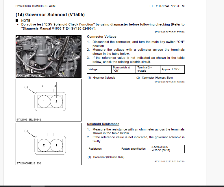

It's not a stop solenoid.
It doesn't work the same way.
You need to get / read / Follow the instructions in the WSM.
Not doing so could be very costly!

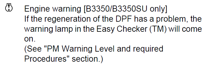

Is there any error code displayed on the hour meter?

Hi all. A friends B3350. Her son shut off, wont restart. Has fuel, all fuses good and have power. It does not seem like it has a good squirt when i crack first injector at the pump. I put a clamp on ampmeter on the green wire going to the fuel shut off. 1.6 amp cranking. Sounds like it tries to start but no. There is a light on the display that concerns me, the red light that is a crankcase silhouette with an exclamation point in the center.
The light you're describing is for the DPF regen.

Oh. I forgot because I unplugged it. It beeps a medium beep when I turn the key on. So that red light, and medium beep ko engine off
