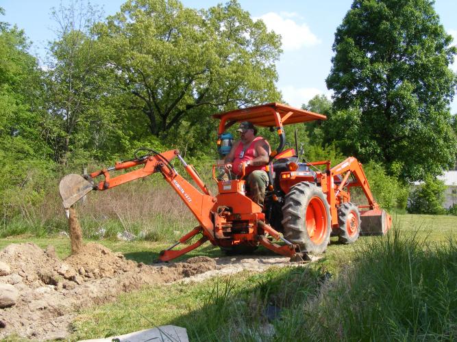

My B670 backhoe takes about 15 minutes to remove & about 20-25 to re-attach to my B7100. (subframe mount) The hardest part is getting the blocking to set it on at the correct height for an easy install at the next mounting.

Lil Foot, that pic takes me back. I had a 7100 setup just like that. The only difference I see is the wheel weights. From what the pic shows that sure is a clean little beast.
7,285
2,240
Bulldog- thanks, it's getting there. That pic was right after the backhoe rebuild.
