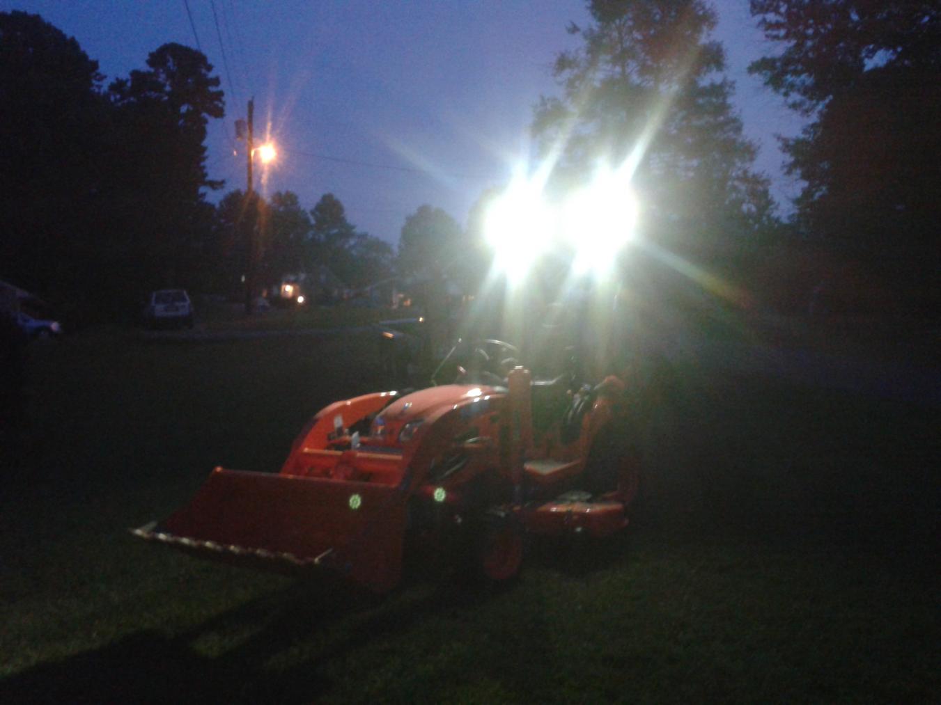

LED lights won't strain a 12volt lawnmower battery! I got mine off of amazon, these are very well made, heavy aluminum frame and bright too boot!
According to spec's you B3200 should have a 14.2 amp system, or maybe is has the 40 amps system, you might be able to see the output on the alternator.
Here is some that I have :
http://www.amazon.com/Genssi-Light-...380549334&sr=8-6&keywords=led+off+road+lights
27 watts. Take that and divide by 13+ volts and you get a little over 2 amps per unit.....
I need to order another set so I can use the backhoe too;)

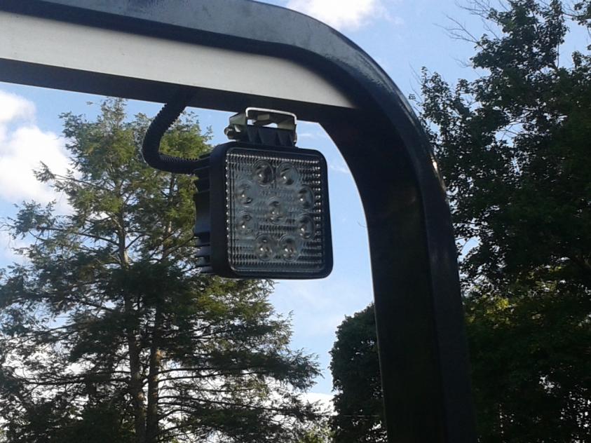

They do not "swivel", they are locked down via a nut - so moving back and forth would not a be good thing, tweaking would be ok I am sure you could design something for the bolt to spin in!. One light would be rather bright, zip ties would not be my first choice, these guys are fairly heavy.....how about a hose clamp or two? I was really impressed with the lights. I think once you get them up - you'll want two more! Running the power source was a beeeeaaauch however, trying to make sure that nutting binds or rubs against the wire inside the wireloom.:eek:

ended up ordering (4) of the lights above. Should light things up pretty good! I'm going to make these quick disconnect, so I can take them down when I mow around the trees to avoid breaking them off in the summer!

We just mounted three to a L3000 with a simple angle iron bracket and square u bolts.
