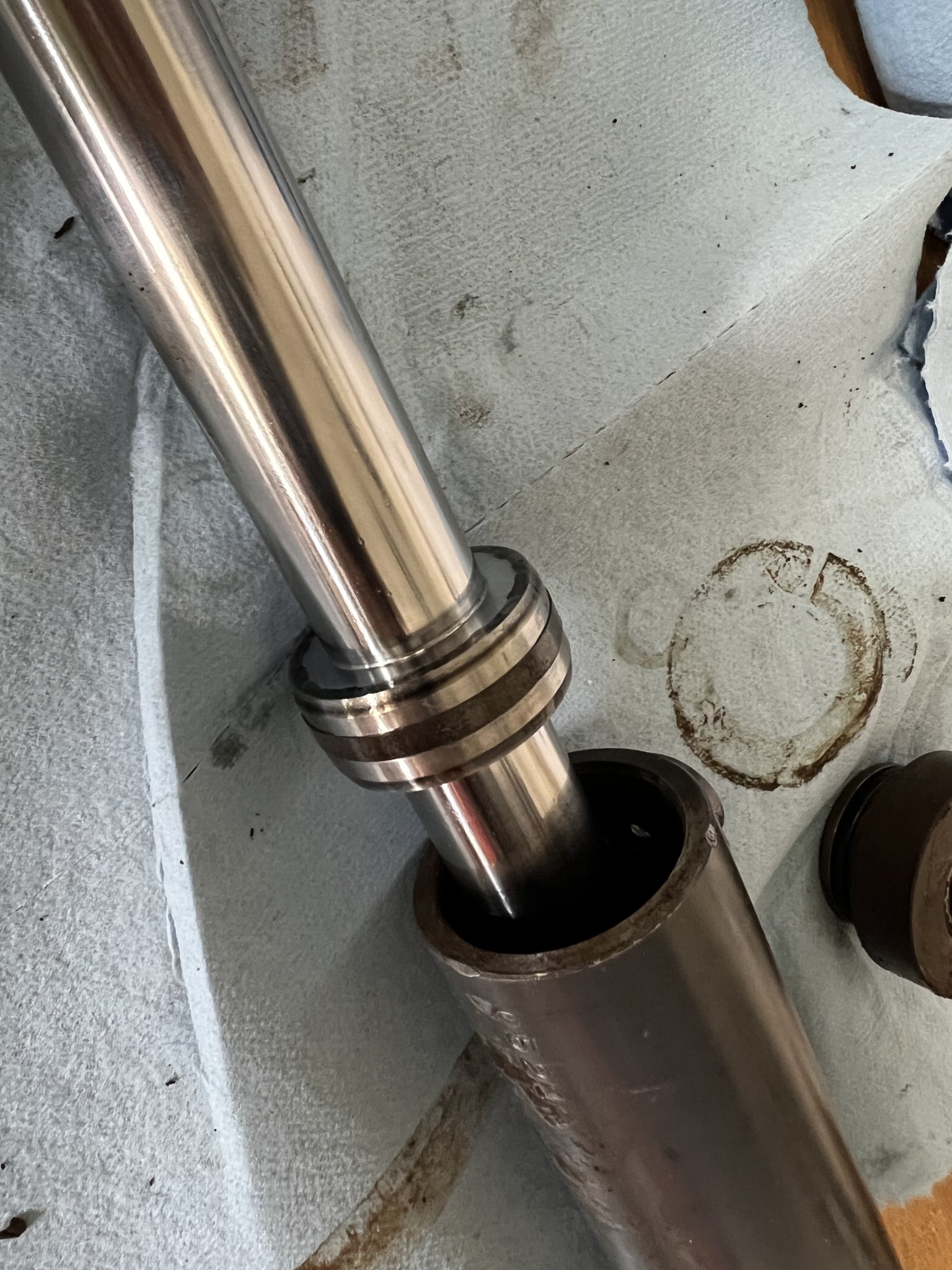

I have a B3030HSD with a similar steering issue. I’ve removed the cylinder and rod.
Parts to order?
In terms of parts to completely rebuild seals and gaskets, would I need to order the following parts?
Does anyone know if there’s a rebuild kit available?
I’ve also posed these questions to Messicks and Coleman.
Parts I’m considering (also see screenshot):
2 quantity:
* 30
* 40
* 60
1 quantity 50 - assuming that 50 is the center seal.
The existing 20s are discolored, but given the price of replacing those, I’m considering reusing them.
Although not shown on this diagram, I also plan to reuse the two snap rings/clips that retain parts 20 in the cylinder holder.
It looks like the total of the parts listed above will be around $190 without shipping.
Since a complete cylinder with parts appears to run $800 or more, I’d like to go the rebuild route unless the design of the original cylinder is flawed and I should expect it the replacement seal to fail relatively quickly. (I got about 600 hours on the original).
Removing the cylinder
BTW, removal of the cylinder was challenging for me. The workshop manual didn’t offer much detail. Here’s what I did:
1/ Removed metal guards.
2/ Removed supply lines.
3/ Removed steering linkages from wheel carriers (I had to pull the top of the linkages up and to an angle to force the bolts to not spin so that I could remove the slotted nuts).
4/ Removed snap rings/circuits from the outer side of each part 20 (cover - rod) shown in the diagram above.
5/ Used wrenches on each of the tie rods and ended up loosening and removing the right hand tie rod.
This is the point where I was challenged. Although I could rotate the cylinder, it would not easily move laterally. Given that the left carrier has a cutout for the supply line attachments to slide through, it was clear that I eventually needed to pull the cylinder out the left carrier to the left (from operator’s perspective).
After spraying some lube around the part 20s, I ended up pulling the rod along with the still attached left tie rod to the left several times which broke loose part 20 on the left and removed part 20 and the entire rod from the cylinder.
Next, from the right side of the tractor, I was able to knock the right part 20 and the cylinder toward the left of the tractor. The right part 20 fell to the floor. Then the cylinder was able to be slid through the left carrier.
