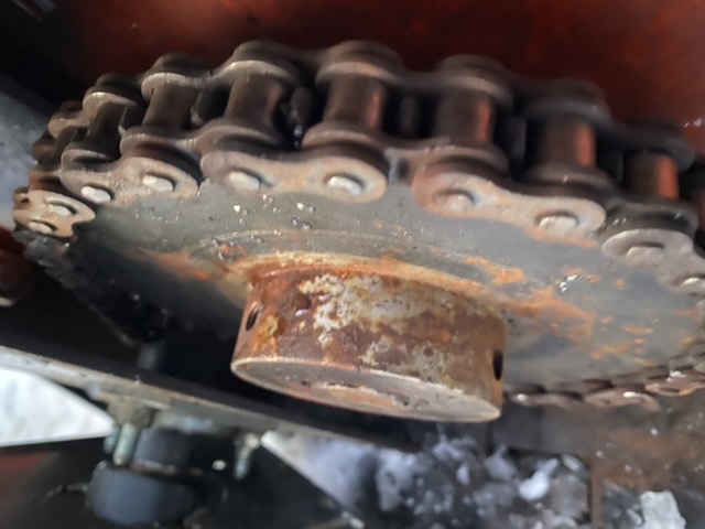

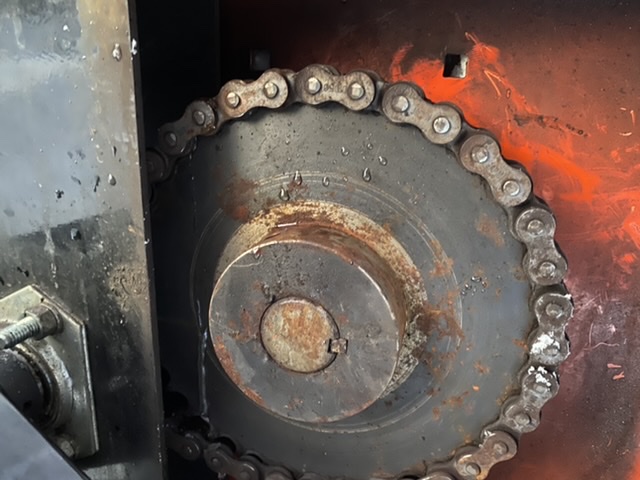

Bought a B2782 a couple weeks ago and these first two storms I’ve used it I’m going through fan shear bolts like crazy. Looking at old threads on here I decided to take a look at the chain and sprockets. The larger sprocket has tons of play. The key is still present in the key way but there’s tons of slop. Also the master link on the chain is broken/hanging. I’m thinking new chain and sprocket. Does the key come with the sprocket? Are these parts even available still? I’m attaching some quick pics I took.
