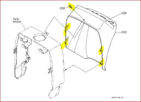

Regulator / rectifier is under the panel cover left hand side.
Looks like only one screw on top and then cover comes off.

If your 2710 is like my 2410 then it is the location NIW described. However you need to pull the dash (I think Kubota calls it the "Intelli panel" ) You will see little indents along the top of the panel. Insert a straight blade screwdriver and pry the dash out. Next remove the tach cable from the back of the dash. Then the wire harness will unplug. You will see the regulator above the fuel tank on the left hand side. Once again this is how it is on a B2410 so I hope my advice is correct for you.
