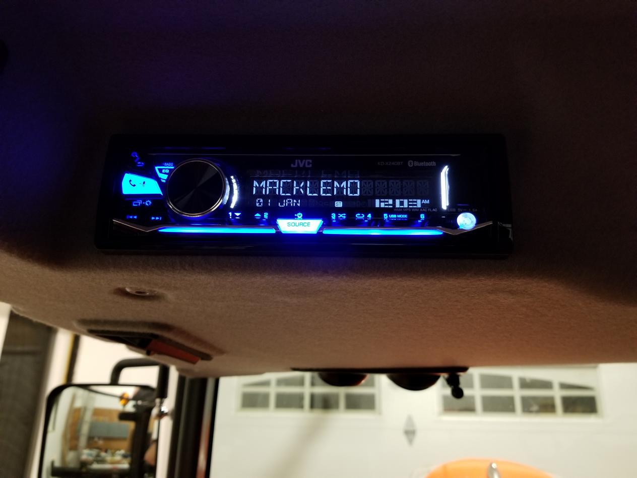

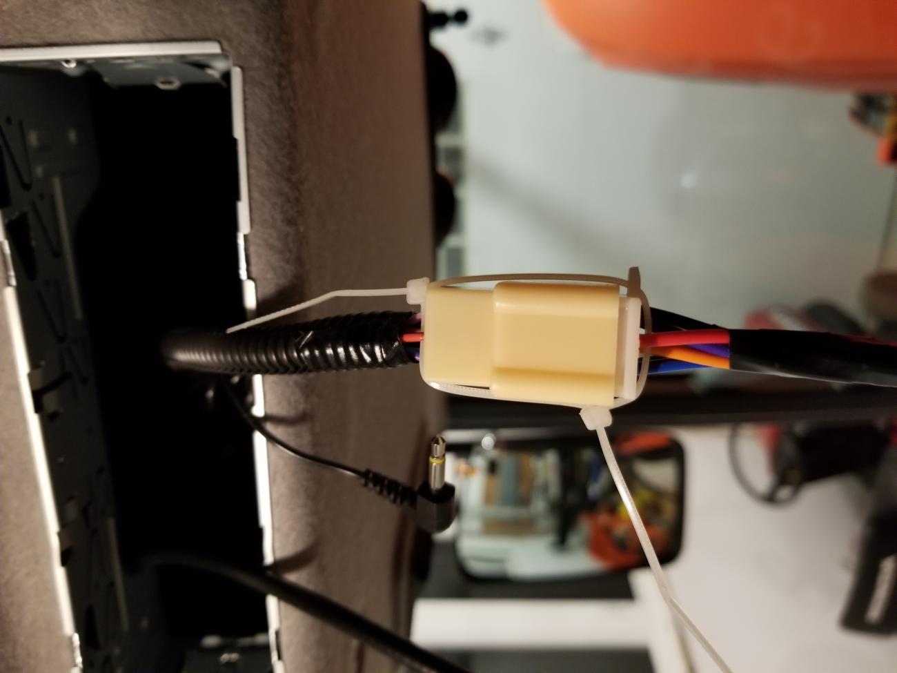

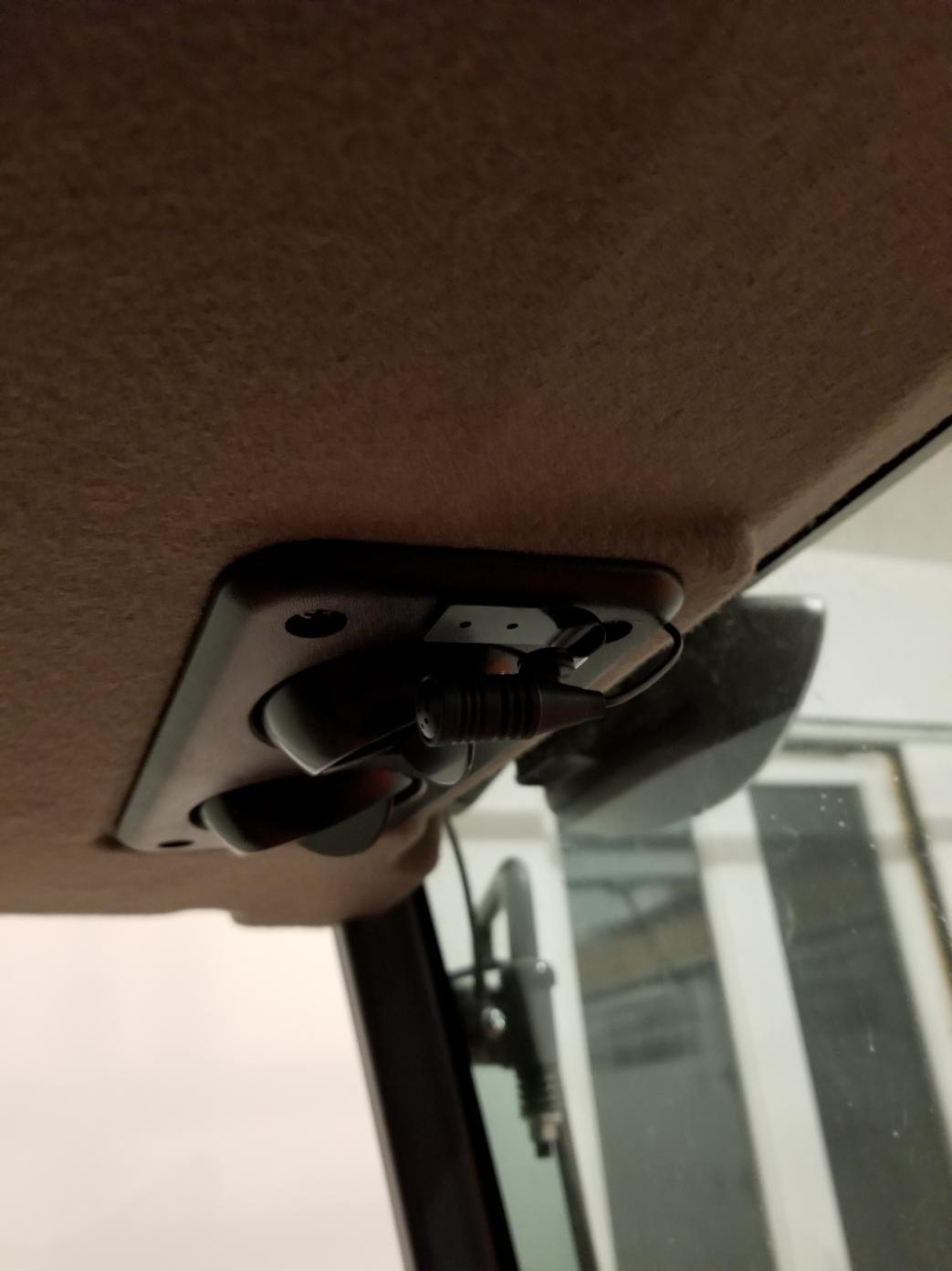

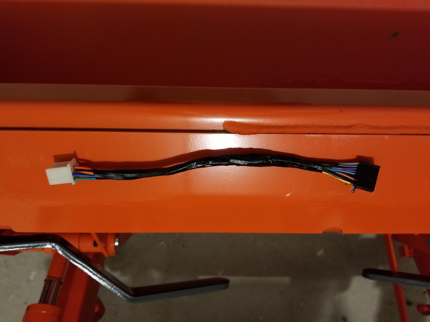

Bevan175
Kubota B2650 HSDC
Aug 11, 2017
30
Ontario, Canada
Couple pictures. Wired up the jumper harness. Installed with Microphone for Cell use. Fed the mic wire out the front HVAC vent and adhered the mic to the plastic. Works well for some background tunes. Plowed snow for an hour and it was nice to have music!
