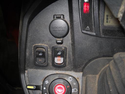

I used a factory switch in the knockout on the dash of my cabbed B2650. I'll snap a pic and get back to ya.
Right-hand switch under 12v plug socket. If I recall correctly, all the wiring was in place already, just had to slip the connectors over the tabs on the switch and snap the switch into the dash plate.

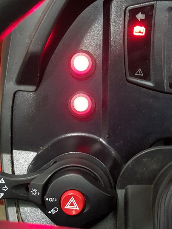

Tap out the blank covers (they use a little glue to secure them at the factory) and these go right in without modification. Just try to keep water out of them.
Search Amazon for this:
NTE Electronics 54-645-A Round Hole Illuminated Rocker Switch, Square Bezel, SPST Circuit, ON-None-Off Action, Nylon Amber LED Actuator, 0.187" Quick Connect Terminals, 20A, 12V

What Chad said. It's been quite a while, but if I recall the wire ends were tucked up under the top of the cab. I did have to clip off the connectors and use waterproof butt connectors as I couldn't find that style of connector for the LED lights I used.
