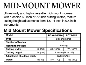

What is odd is I only see the 72" as an option, what deck do you have on it now?
11,045
2,951
I bet he has the RCK60-30BA

BTDT on B3350 and little needs to change.
Front frame mounts are different.
IIRC, rears are same.
If you speak to your dealer, be certain that you speak to an experienced parts person rather than a salesperson.
Be advised that you cannot mount the 72" mower if you have turf tires or use wheel spacers.
