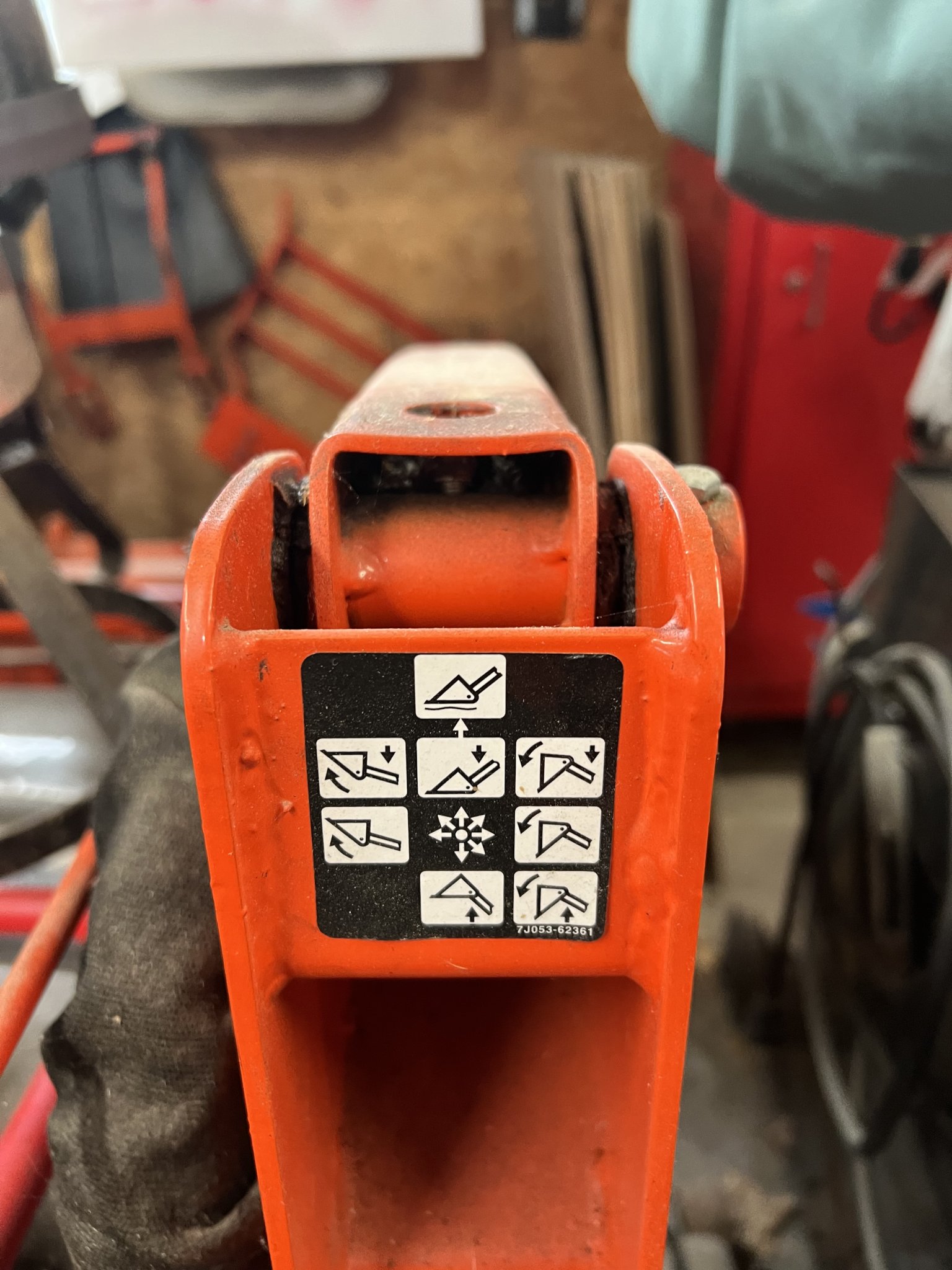

Yes, what I’m wondering is if this is not an HST whine at all. Something related to the loader hydraulics.
It comes up sometimes, but there’s the “lift/curl” aspect.
@KTuk4J - do you get the noise when going into a pile, and trying to lift and curl the bucket at the same time?
Transcends many models of Kubota tractors from small to very large.
See how there’s nothing at 7 o’clock position?
According to Kubota the loader won’t work there. I get a pressure relief noise when trying to lift/curl. Usually it’s just a second or two, but it won’t lift or curl and makes some racket.
KTuk4J
B2650 Duetz Allis 6275 CAT D6 CAT 110B
Mar 2, 2020
112
15
NW OR
It's with lift, the heavier the load, more the noise at operating temp.
There a couple of things I need to sort out and try with the loader/connections as mentioned.
