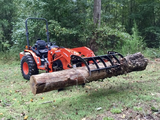

Bought this for my 2650, Everything Attachments Compact Wicked Root Grapple 50". It did everything I needed on the 2650. Sold the 2650 and bought a L3560, I'm going to use it on that and I don't anticipate any problems.

I also have a B2650 and I have the 55" EA wicked root rack grapple. Works well with the tractor and the loader.

I also have the B2650. Added the Land Pride SGC0660 grapple to the collection a few years ago and have been very happy with it. No issues at all. Highly recommend!

My tractor is an L3560 and I purchased Bradco grapple with it a couple months ago. I’ve been very pleased. I have also had very good luck with Everything Attachments EA. I’ve purchased their brush hog, box blade and rake.
