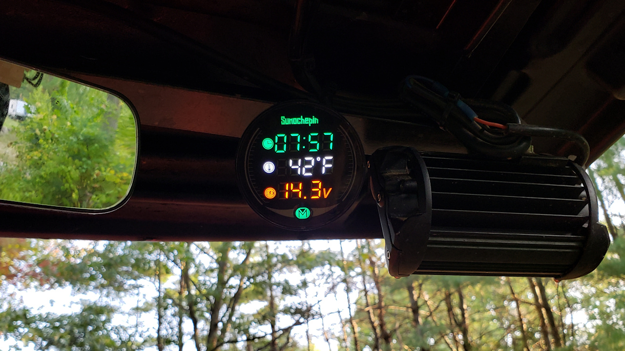

Watch the voltage, that will tell you if there will be any issues.

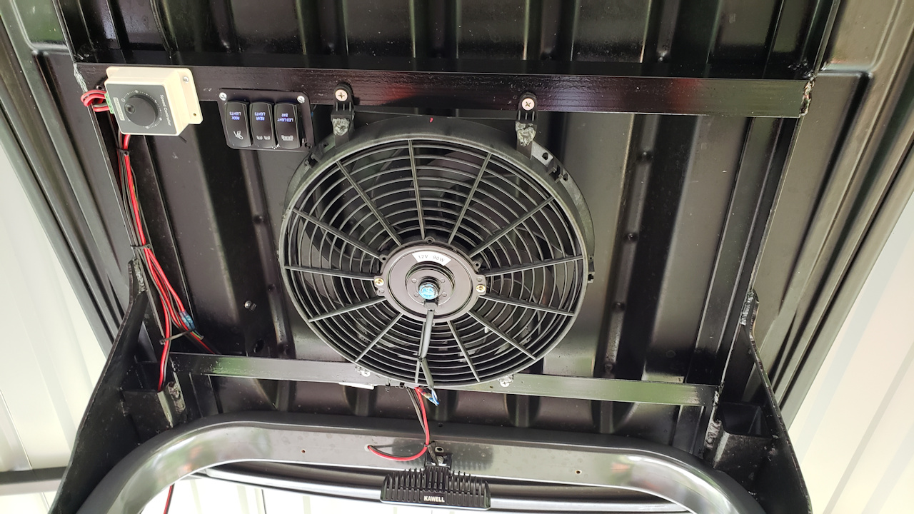

Flex-A-Lite model 116 - 16"fan, 2215cfm, 11amp draw is what I used in post
