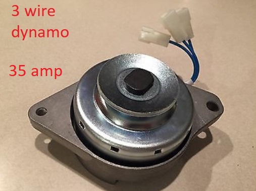

There is another possible option, John Deere has a 3 wire dynamo on some models which has an output of 35 amps.
In some Kubota situations it may be an easier fitment.
Rectifier/regulator would also need to be changed.

That JD dynamo may be an option, but my intent here was to show off a system upgrade that doesn’t require a single modification to the tractor or any fabrication. While a lot of folks love to tinker and work on their equipment, others just don’t. This is more for that group I think.
