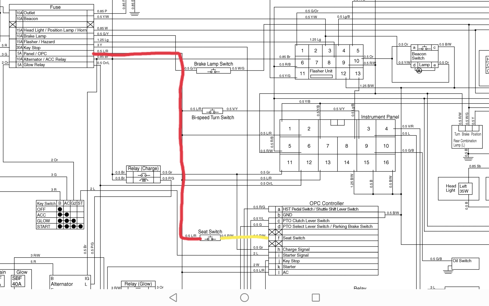

Here is part of the schematics. You find the complete work shop manual with schematics on kubotabooks.com for download.
The seat switch is supplied through the fuse (red) and so is the instrument panel. Switch output goes to controller then (yellow). When you put the seat down the cable to the seat switch shorts to chassis / ground and blows the fuse.
Check where the cable is squeezed, repair it and possibly reroute or attach with cable ties that this cannot happen again.
Good luck with the repair !

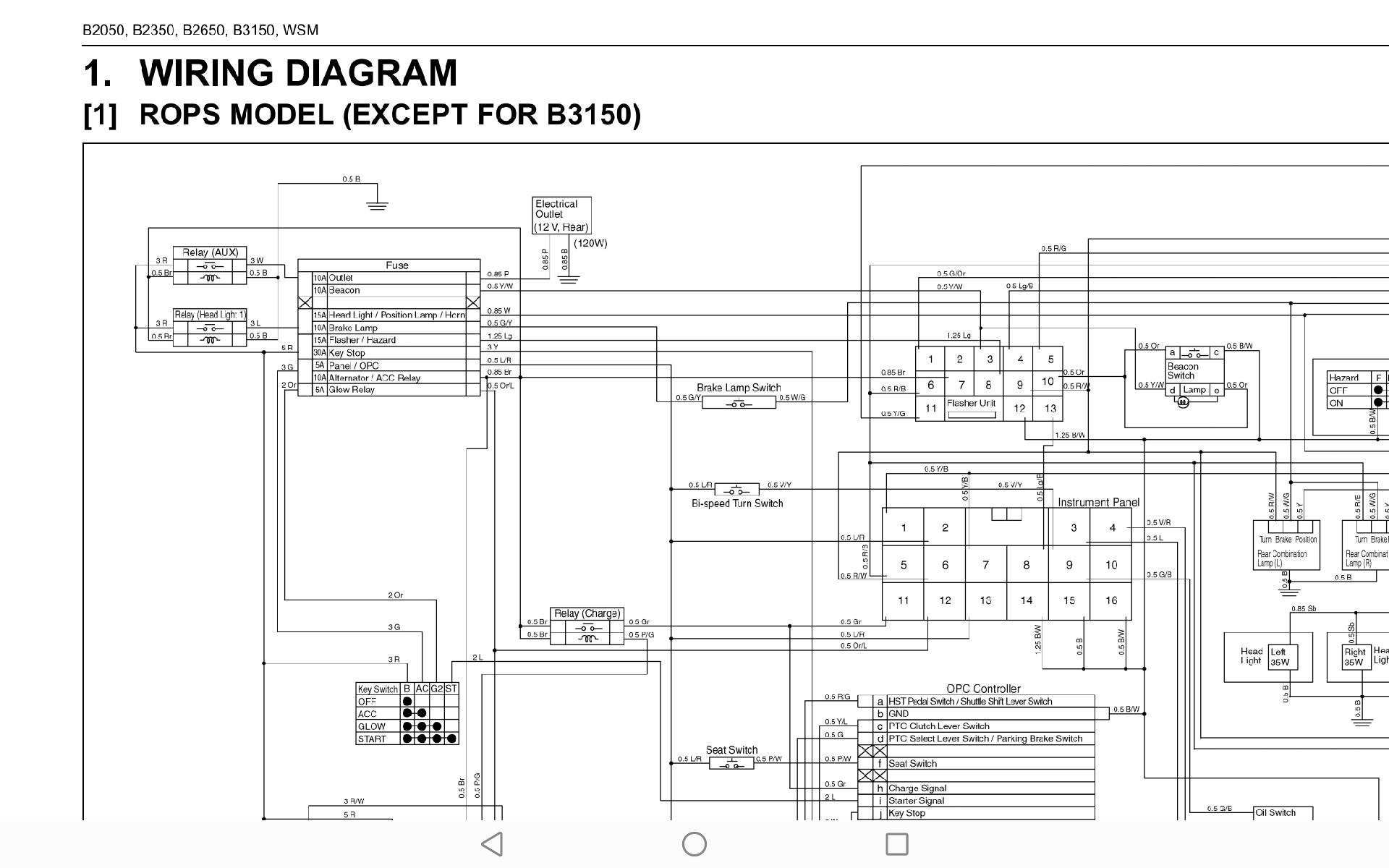

Where did you get that schematic?
It's not a B2650, caught that right away because a B2650 does not have bi speed turn.
Same concept just the right schematic. ;)

I had picked the ROPS version schematic
Yea sorry wrong tractor, that's the EU version, they are really not the same tractor as the US version.
I know stupid confusing.
I didn't make their number system up, I just know how to follow it.
