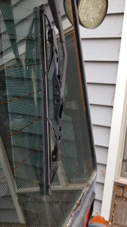

Okay, while I was taking pictures I figured out how to remove the rear wiper.
To remove the rear wiper blade you need to pull the blade half under the arm past its angle stop. After that it comes right out.
Pic 1 is the assembly.
Pic 2 is the arm end with the wiper removed.
Pic 3 is the blade at the angle it needs to be at to remove it.
Pic 4 is the blade removed.
Funny thing is I looked at the assembly mulitple times before I decided to create a post. But for some reason while taking the pics I tried one more time and figured it out. Hopefully this post can help someone else out.

Great description and photos! I'm certain other B2650/B3350 cab owners will find this helpful as their blades wear out.
You'll have to post back the blade # that will work with this mount. With any luck any correct length replacement blade will work with one of the many adapters that seem to come with them these days.

That's the same design as an Asian SUV (Rogue / RAV4 / Pilot) rear wiper. Post a length and I can probably get you a part number.

Length is 12"
Looking at some picture online the Toyota RAV4 looks to be the closest one. It makes sense too being Kubota and Toyota are both Japanese companies.
Probably...." Maybe" is closer.
There are now 5 Roc-Lock designs ..... there used to be 2. Definitely take the old one when you go.
Trico numbers are:
12-A <<< I believe this is the one
12-B
12-F
12-J
12-K

Here is what fits... I tried a trico rear 12" 55-121 using adapter A and it works fine.
Pau7220 got it right with the 12-A blade that is the exact replacement size.
