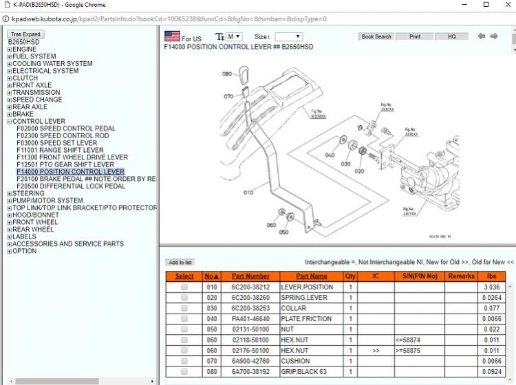

I'm familiar with the controls.....what is missing is the little knob/screw on the 3point control on the right fender that allows you to set a STOP at some level.
On my tractor this screw knob is missing.....

I didn't get that clearly from your original post. My B2650 does have a lock nut to set a stop on the 3 point position control. I checked the Kubota parts list and, curiously, it doesn't show this part as you can see on the attached image.
You can see it, though, on page 50 of the Operator's Manual but there is no discussion of it. Also curious is that page 51 of the Manual shows a "lowering speed knob" between the operators legs. My tractor does not have that knob.
I would just call the dealer to ask them whether they can identify the part number and send it to you.
