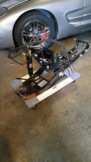

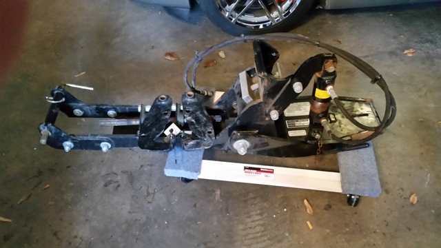

The B2710 is a much longer tractor. The hitch is completely different, but you may be able to cut it down. Problem is going to be with the rear drive shaft. I finally found a pic of the hitch you are asking about. It is completely different where it mounts to the tractor, and it is much too long. Going to be a lot of fab work getting it set up for your tractor. Unless this setup is real cheap, you'd be better off getting the correct parts. I ran into the same problem and decided to sell what I had and buy the correct hitch for my tractor.
