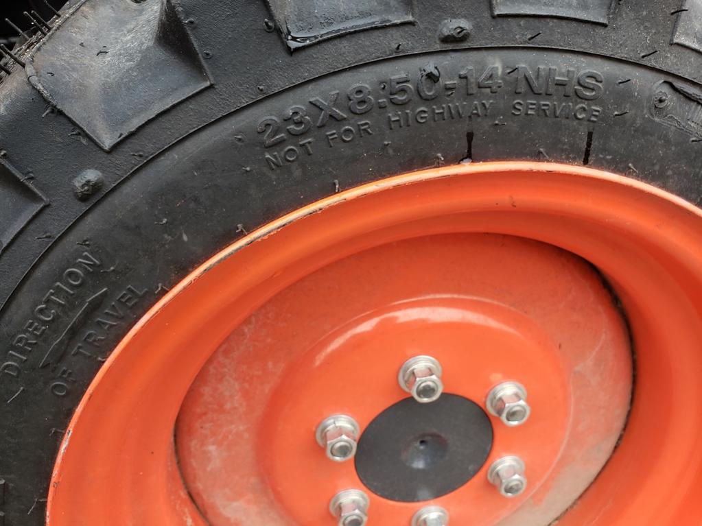

Hey all,
I just upgraded to a B2601 from a B2301 and I noticed it has what looks to be the front wheels from a B2650 on it. The outside diameter of the tires is the same between the two machines. Does anyone see any potential issues with this configuration? I also noticed these new wheels have the rubber valve stem instead of the steel valve stem I typically see on wheels with R4 tires. Is there a specific reason for this? I'm just curious.

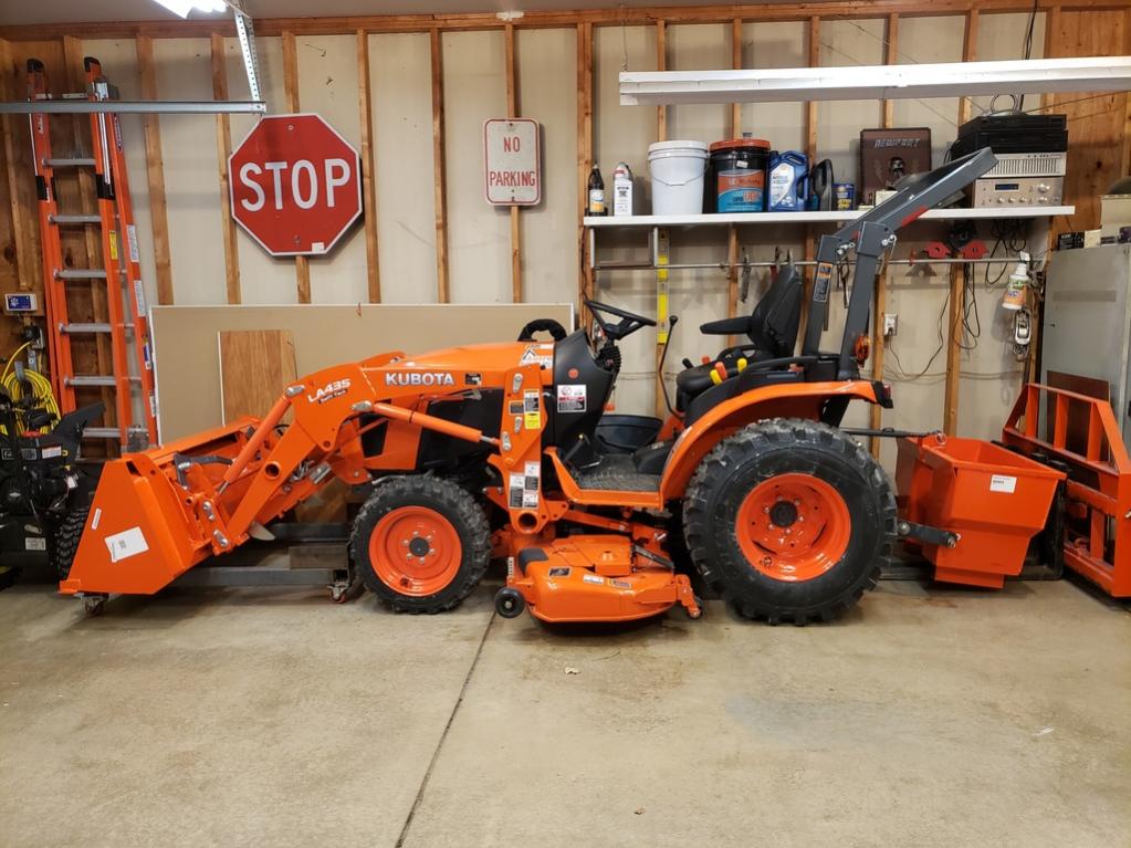

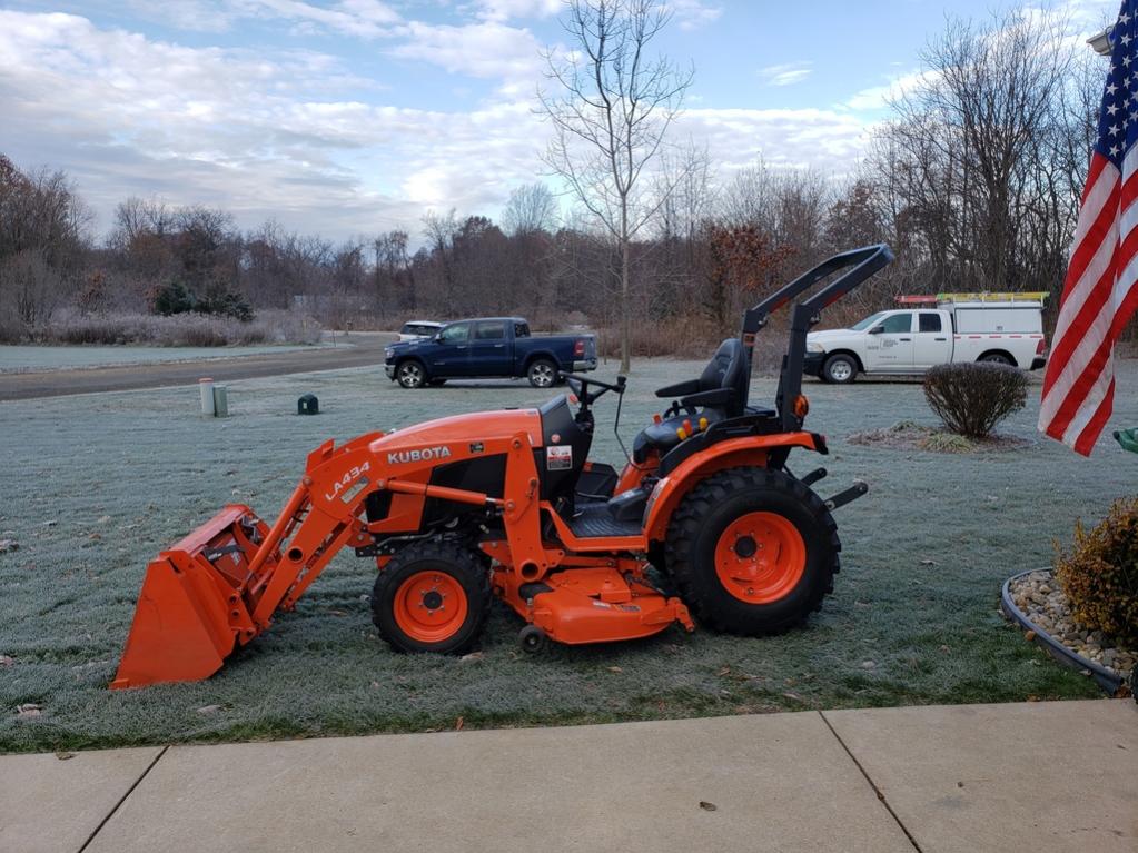

Are these pictures of your new 2601? If so am I reading the size correctly as one is a 12 and the other a 14.
The 12" wheels are on the 2301, and the 14" wheels are on the 2601. The diameter of the tires on both machines are 23" as shown on the sidewall, but the tire on the 14" wheel is 0.8" larger diameter according to Titan tire.
