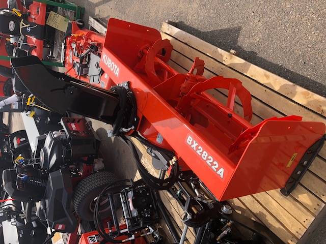

I am in the process of purchasing a 2019 B2601-1. From what I have learned the BX2822A is a K- Connect style hitch. The K-Connect sure appears to be beefier and more user friendly than the previous style hitch. This new hitch has been available the last couple of years on the BX 80 series. Messick's has a good YouTube video of the K-Connect.

My dealer sent pictures of my tractor and attachments. I notice that the chute will be fairly easy to add a hydraulic deflector. No pics of K-Connect. I pick it up Friday morning. I'll try to post more pics once I get the tractor home. IMG_1922.jpg
