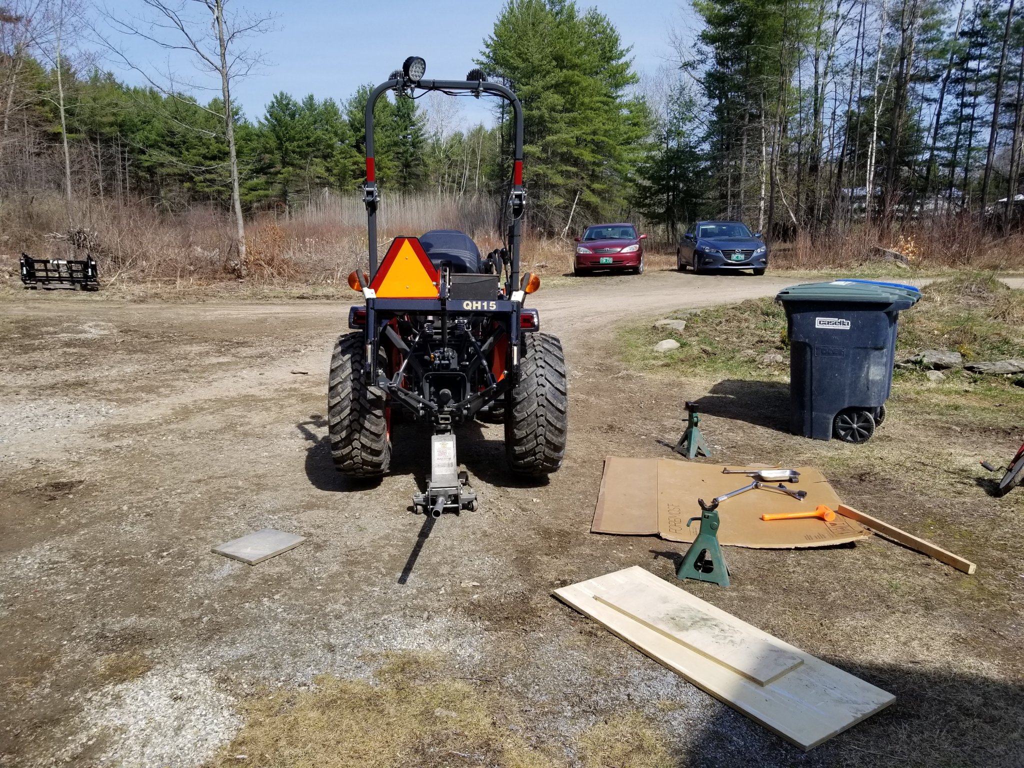

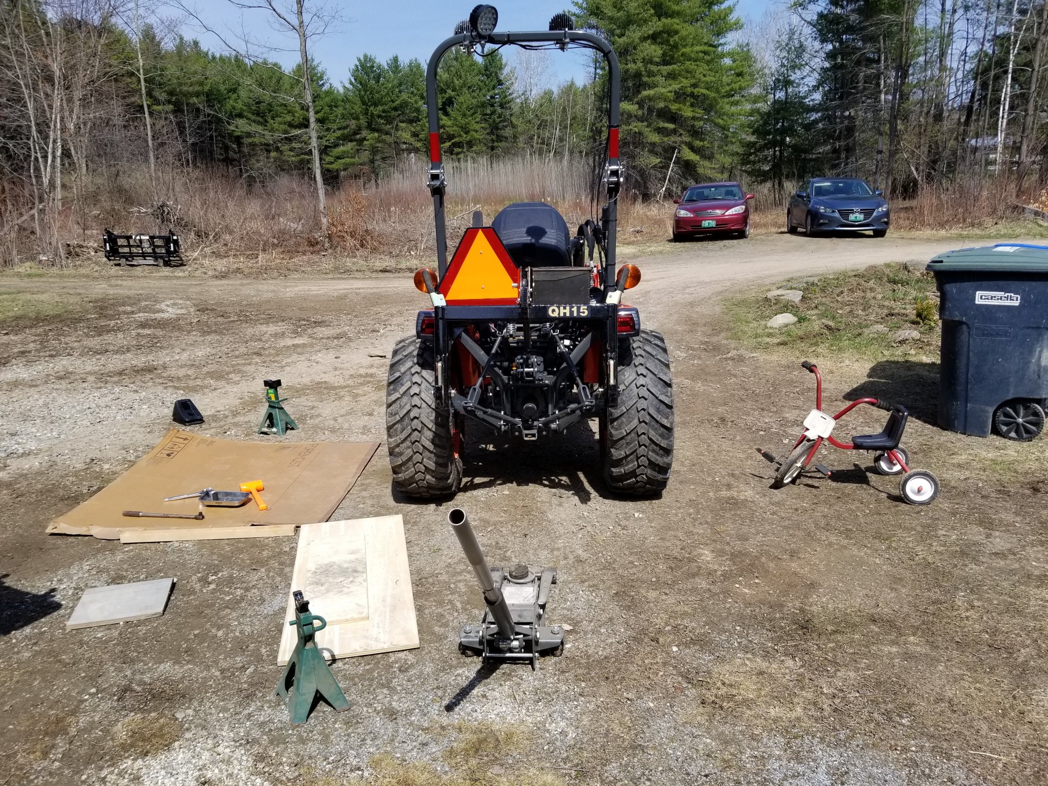

I second the steel wheel spacers, they made a world of difference for mine. I think I did 2.5 inch (I don't use a MMM) below is a shot of mid-way through the install so you can see the left vs right tire difference, then at the end with both installed.
View attachment 75845 View attachment 75846
