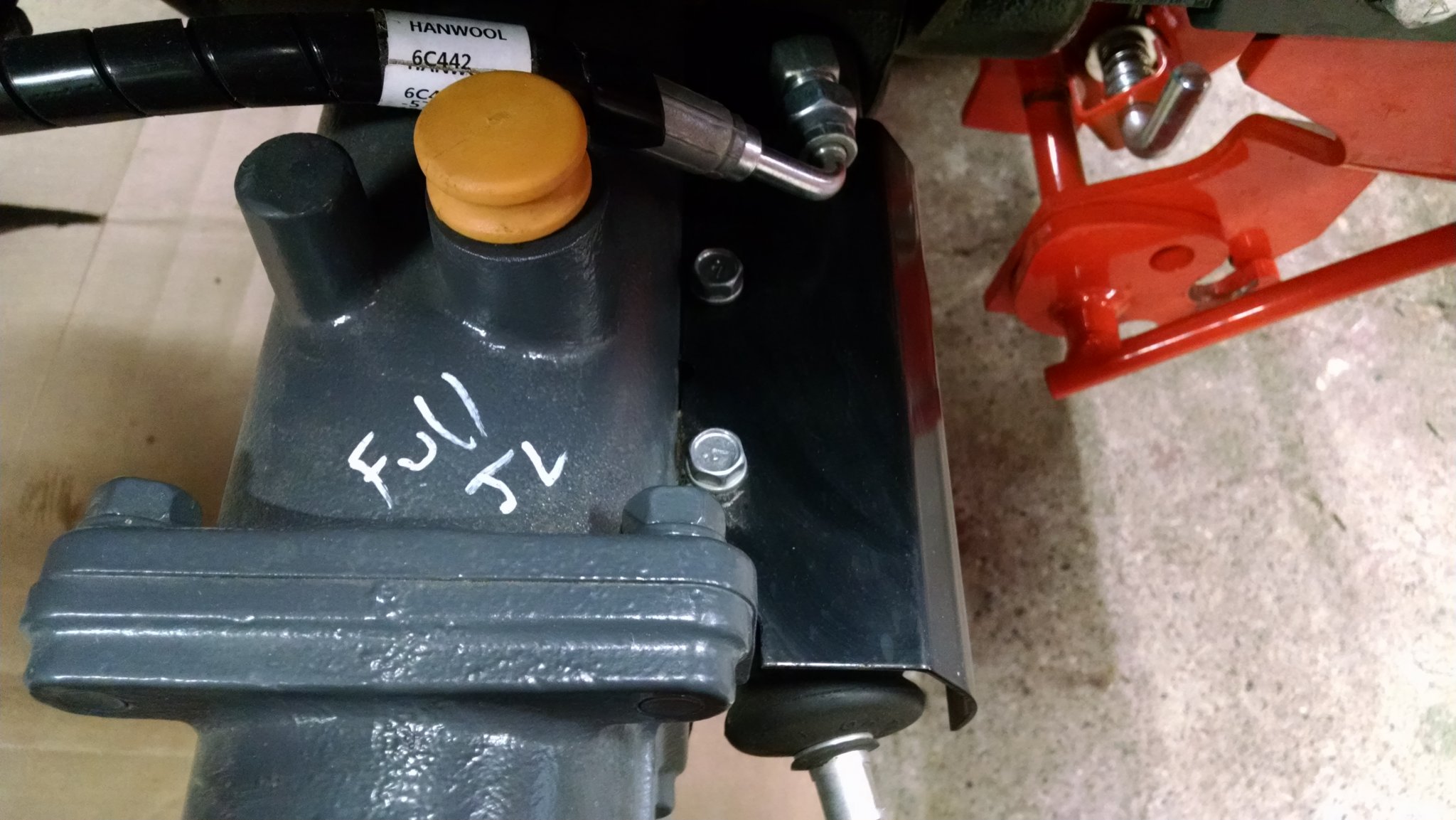

Read a lot of times that the hydraulic oil needs to be checked frequently... So where is the dipstick? I know where the engine oil dipstick is... and the trans dipstick back by the 3 point hitch... even my manual doesn't show a hydraulic oil dipstick! Is the trans and hyd the same one?

The transmission and hydraulic system use the same resivor and use the same dipstick by the 3 point. Also don't forget to check your front axle fluid if its 4wd.

Thanks for the quick reply!
I do have 4WD, how do you check the front axle?

The front axle inboard of the right front wheel. It’s a black rubber cap with the fill levels on a tiny dip stick. You gotta kinda twist, squeeze and pull to work it out.

Make sure you get that front axle cap back on properly. As stated above it is a little difficult to remove, also somewhat difficult to properly re-install.
