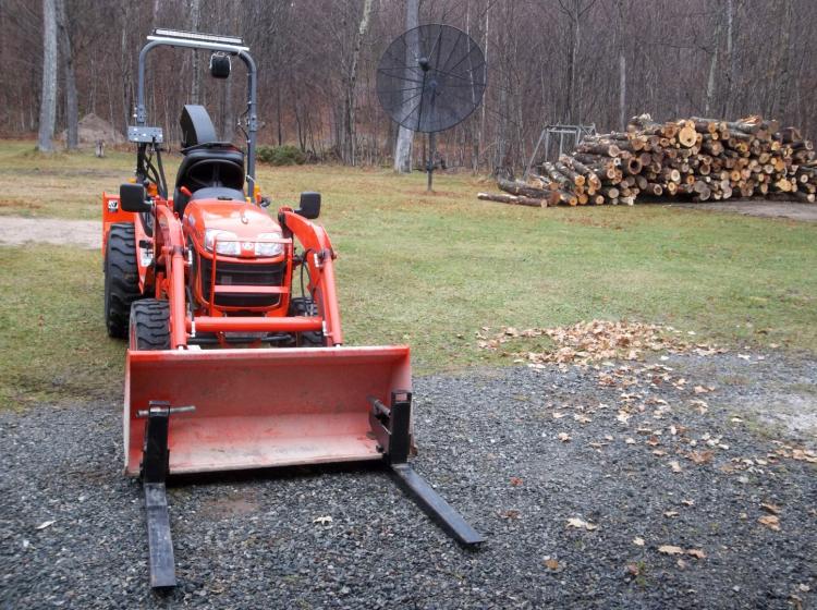

I have the B2620 (basically the same as the newer B2601 capacity wise) and I unloaded a 534 pound crate (wood splitter) off my flat bed trailer with these bucket forks.
They take a lot off your capacity because they add so much leverage out front of the bucket, but it could lift and curl that 534 pounds effortlessly. I was pretty suprised and impressed.
That's the only thing I had an actual documented weight on. And I know it will lift more than that now.
