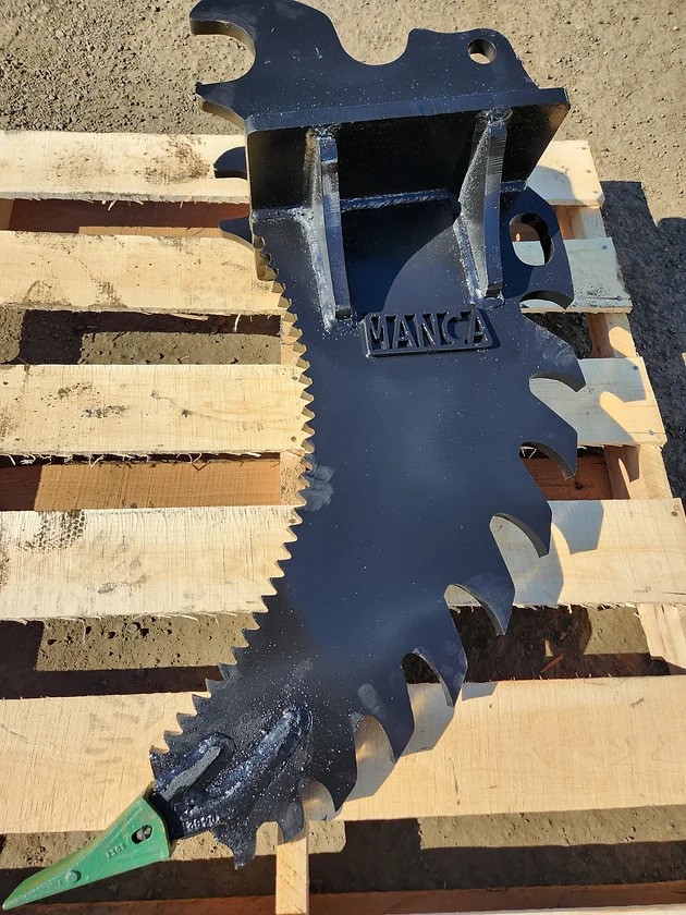

Dave: definitively please, post a pic of your ripper if it's convenient; I'm salivating over the pics everyone is already putting up!
Runs with Scissors: thank you for confirming serrations do help, the fact that it takes subtle technique just means more time playing with the B26...yipee! BTW, I agree that thing does look bad ass. Even my wife took a step back and said whoa! when I showed it to her.

My ripper does NOT have serrations, but will rip to 28" deep.
Ripping depth was a priority for me.
I bought from "OX thumbs", in Carrollton, GA. and the $1,000 price (by phone) included UPS shipping.
AR400 steel, 1" thick.
A quality product, and I really like it!
Am using it on my L48 TLB.
The 28" ripping depth/length (bottom of plate to tip of tooth) is NOT an issue, with curl, for my L48. It does not hi the boom.

Expensive day! Pulled the trigger on the Manca 24". Nice folks, told them I don't need the ears as I will be putting on B26 specific ears and they took hundred bucks off. It'll probably take a few weeks to get everything in, migrating to the B26 quick attach system so ordered all that stuff too. Will post pics when I get it sorted
Fried1765: thanks for the Ox Thumbs heads up. Their attachments look well made and they're somewhat local boys for me, but the Manca with that serrated edge imo was just too bad ass to pass up.

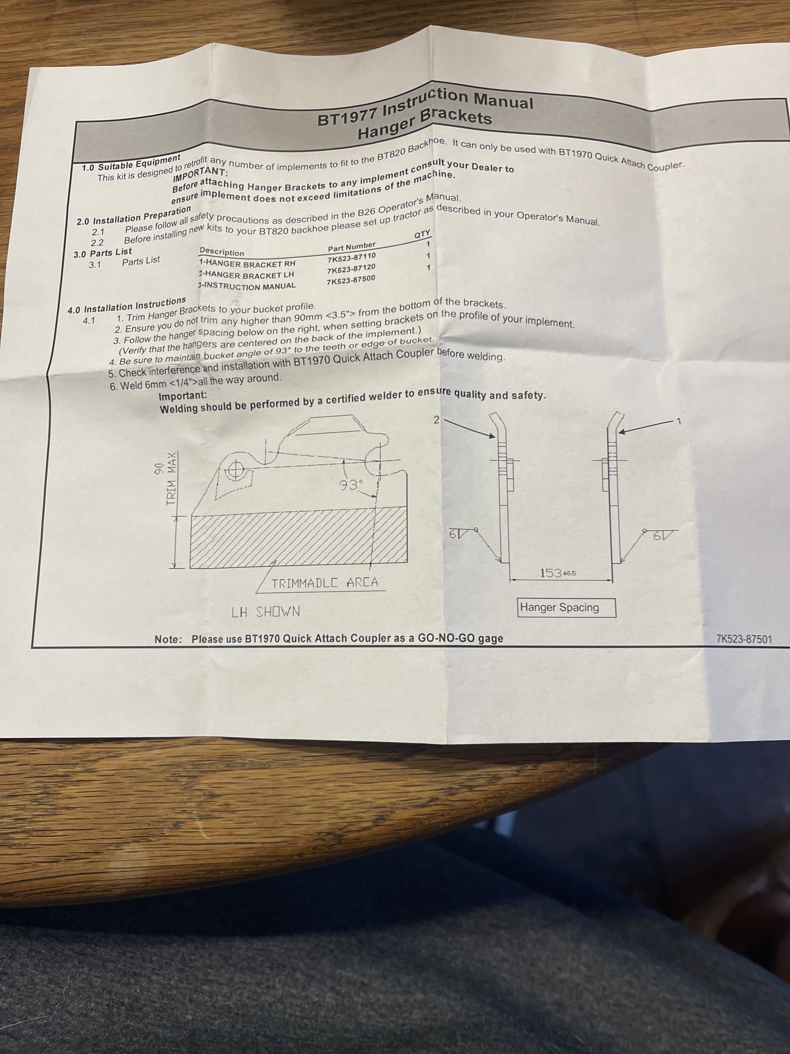

Could you find a source other than Kubota for the qa ears?

I couldn’t find B26 QA backhoe ears other than Kubota. Flare and inside pin weldments stops makes them a little more complicated than just plates. I think they were $260. Was going to make a pattern but didn’t. Probably the easiest QA I’ve used. With the KX040 adapter could now use $80 simple plate ears or attachments.

No, it does not. the B26 TLB has a quick attach backhoe bucket (BT1973) and uses the mating QA (BT1970 quick attach coupler). Ultimately, I want a root ripper that will fit this set up. In the meantime, I am hoping to track down QA ears that I can use to modify another ripper attachement.

Kubota backhoe QA ear instructions.
Cost $221, freight $25
I had the part number from Wholegoods list. if you go to the local Kubota parts and use the part number they will not be able to find it. Parts manager told me to buy a bucket and cut the ears off! That’s too expensive and wouldn’t work anyway. Got the owner and sales manager involved to order them from Wholegoods.
if ordering from Messicks ask for sales not parts.
I like the adapter to be able to share attachments. Haven’t tried anything other than the ripper. Find the ripper saves time, effort and hole size removing stumps.
