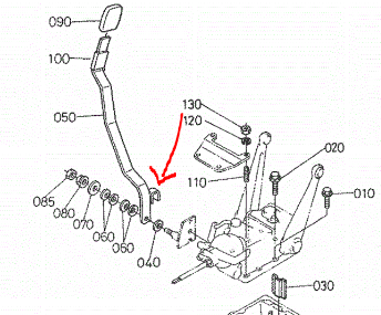

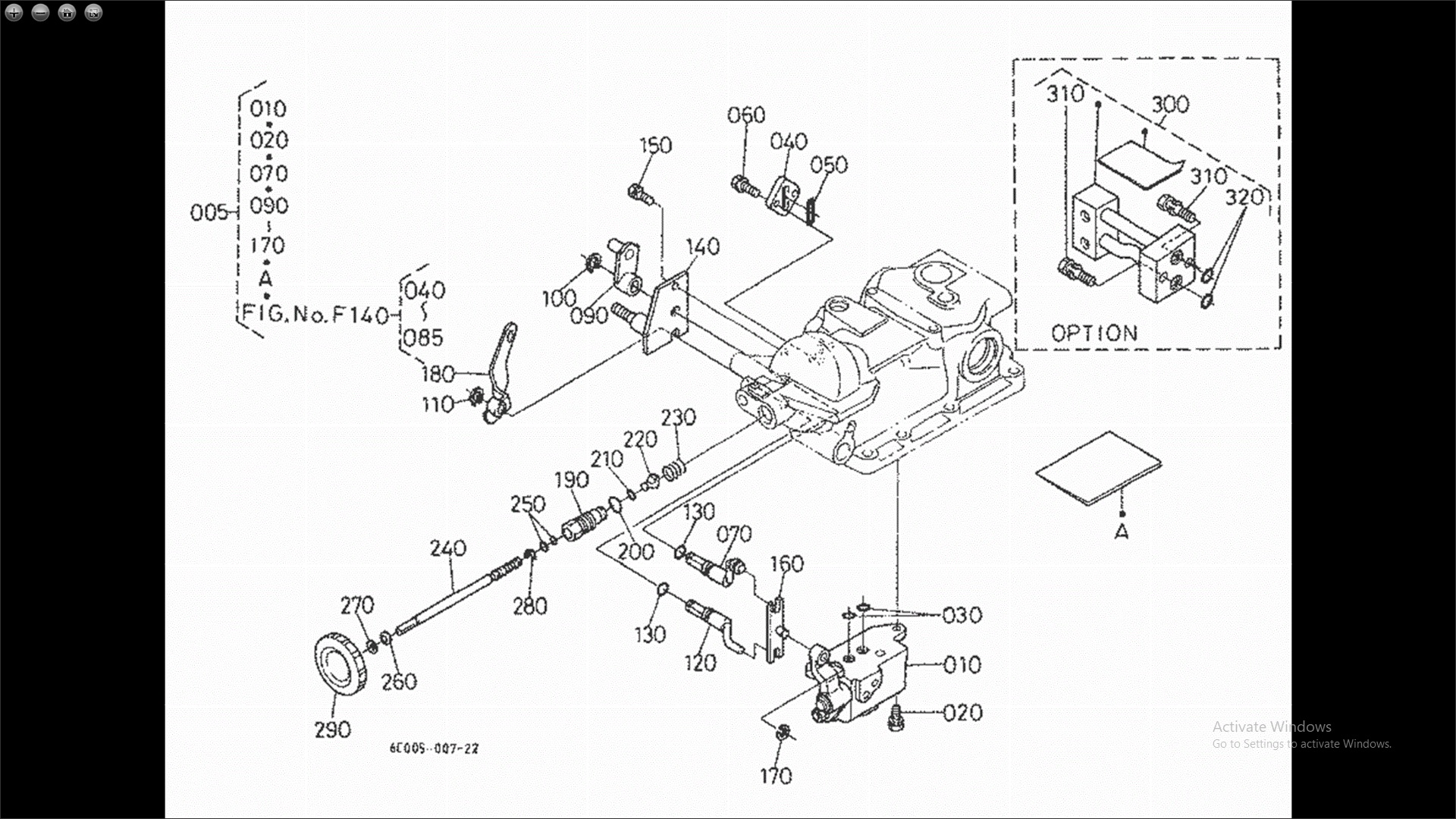

Thank you for the reply. Problem is on this model there is a c clip (#100) and not a nut. Shaft goes through the cylinder case (#70) to work the control valve. The threaded shaft on the bracket (#140) is for lever to engage 4WD

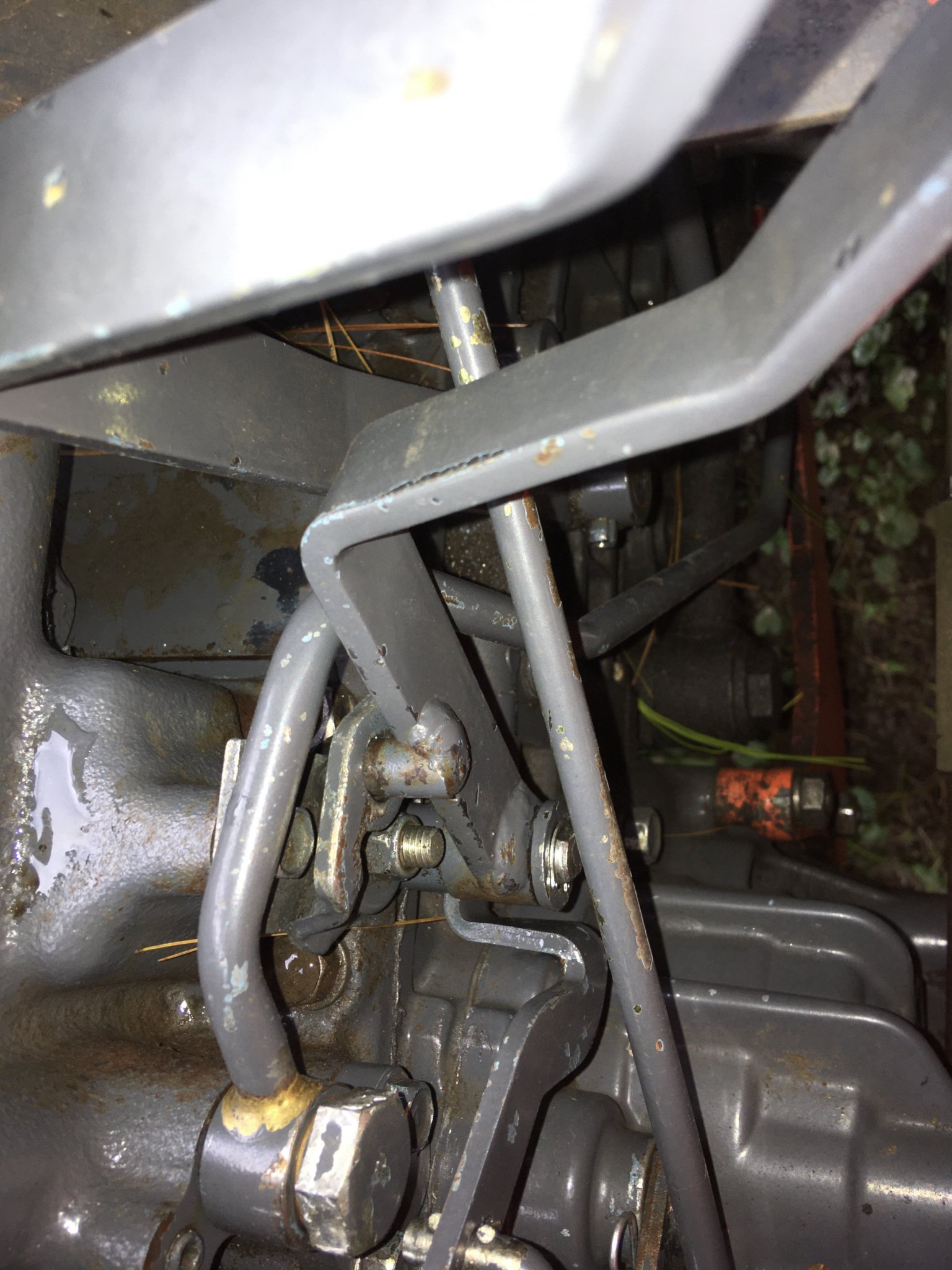

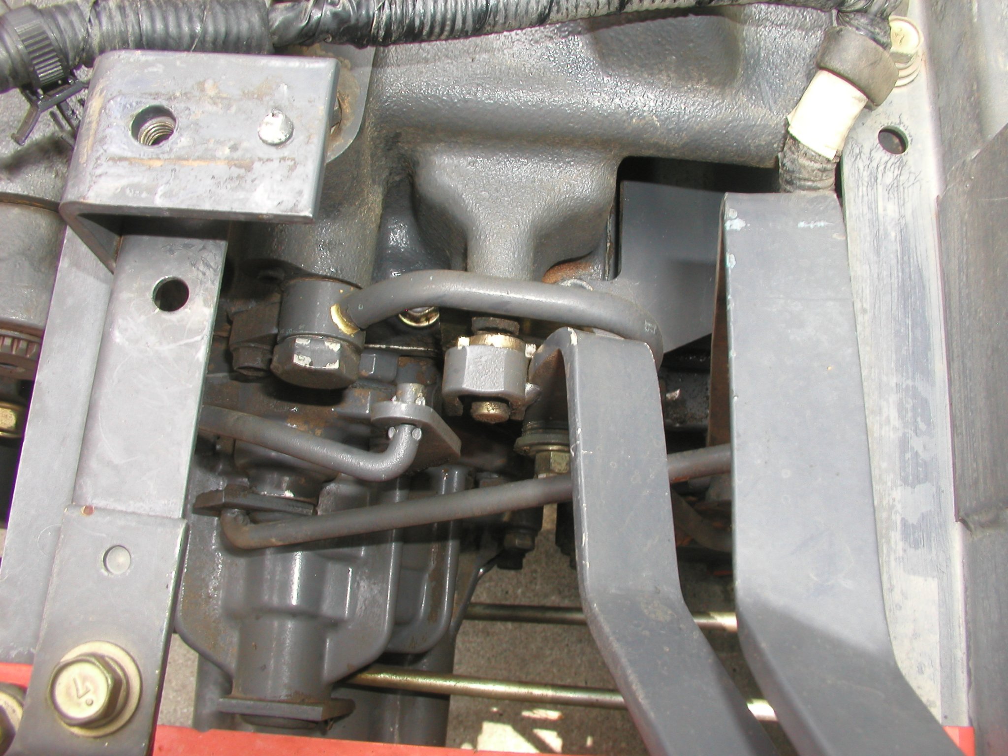

After going for more photos I gave a bit of misinformation and the 4WD lever is lower and not shown in the schematic.
What I have is slightly different on the side than shown in the schematic and looks identical to the photos in the service manual. The lever itself has a pin that moves the actual adjustment for the position control valve. The lever slides onto a bushing over the lower shaft #120 which is controlled by the feedback lever. All is held by a C clip. The nut that holds the equivalent of #90 is bottomed out on the shoulder of the shaft. A few photos

There are two styles of 3-point lift hydraulic control valves on these models. My B1700 has the new style that is pictured in the parts diagrams. I bought mine new in 1996 and the old style was swapped for the new style then by the dealer. The new style has a control valve that operates more smoothly than the original; you can tell that you have it because the lift will slow down and stop smoothly during the last inch or so of lift. Another way to identify it is by the lift control lever pictured in parts diagram F14000 Position Control Lever, part 50. It will have an upside-down U-shaped tab welded to the lever, as indicated by the arrow in my screen capture.
In that diagram, notice two nuts, parts 85 and 80, and some conical washers, parts 60. I believe those are what lugbolt is referring to. I can't tell for sure from your photos but it looks like your position control lever is different, so is probably the older style. Here is a photo of mine, the newer version. The semi-circle tab captures a cadmium colored peg in the precise middle of the photo which operates the control valve, per part 90 in the J040500 Control Valve parts diagram. Just down and to the right you can see the nuts and conical washers, all compressed. That said, I believe there is more than these conical washers holding the lever and control valve stiffly in place, but I don't know what!
I'm not sure that this will be of any help to you since it appears that you have the old style, but at least you might determine if this is so and go forward from there.

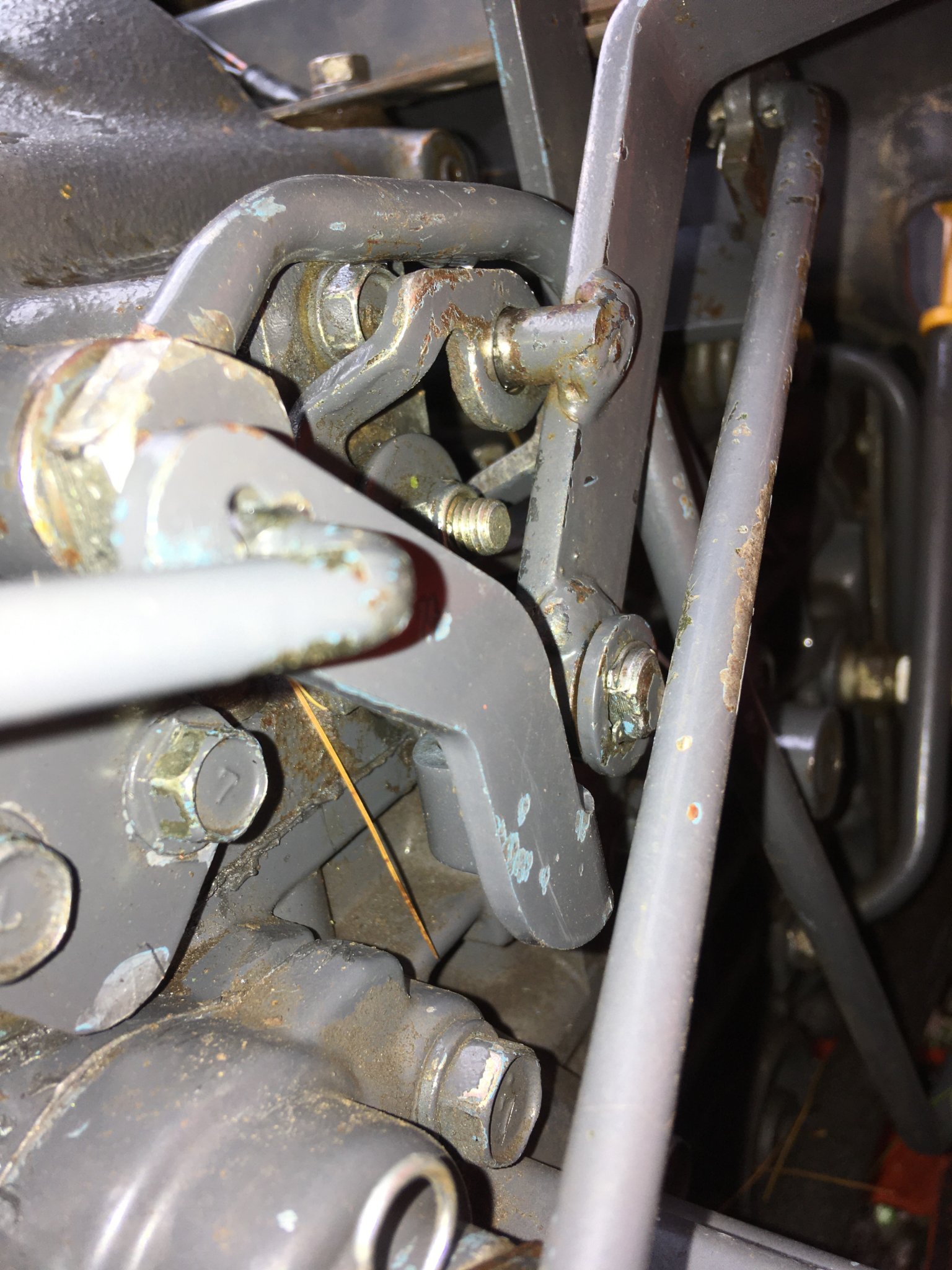

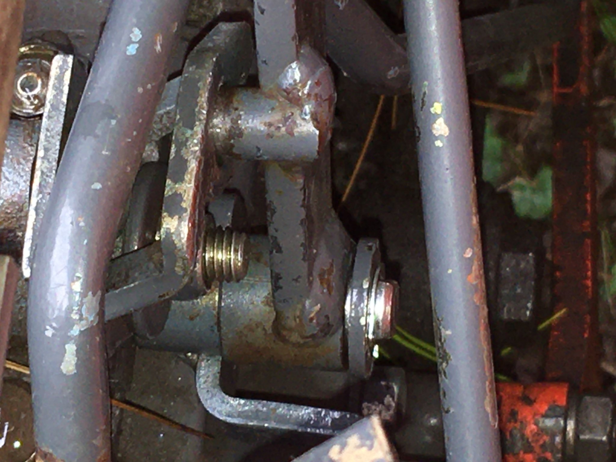

Photos following. I'm thinking (without looking at the above referenced materials) that the friction should be on the part with the nut on this version. I added a plastic washer (which I didn't get any photos but simply temporary as proof of concept) to get past the shoulder a bit and apply pressure. The lever stays where I place it now.

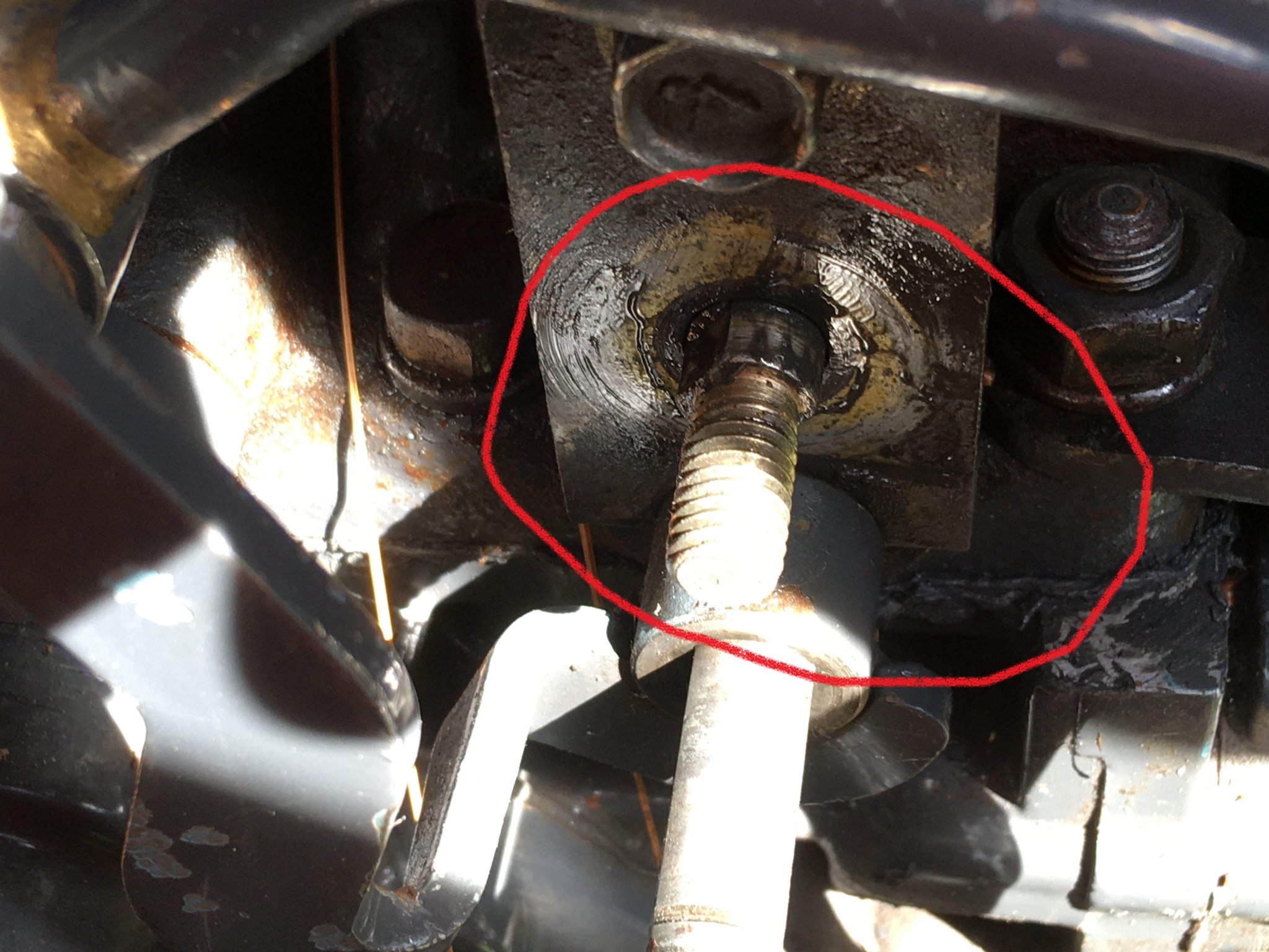

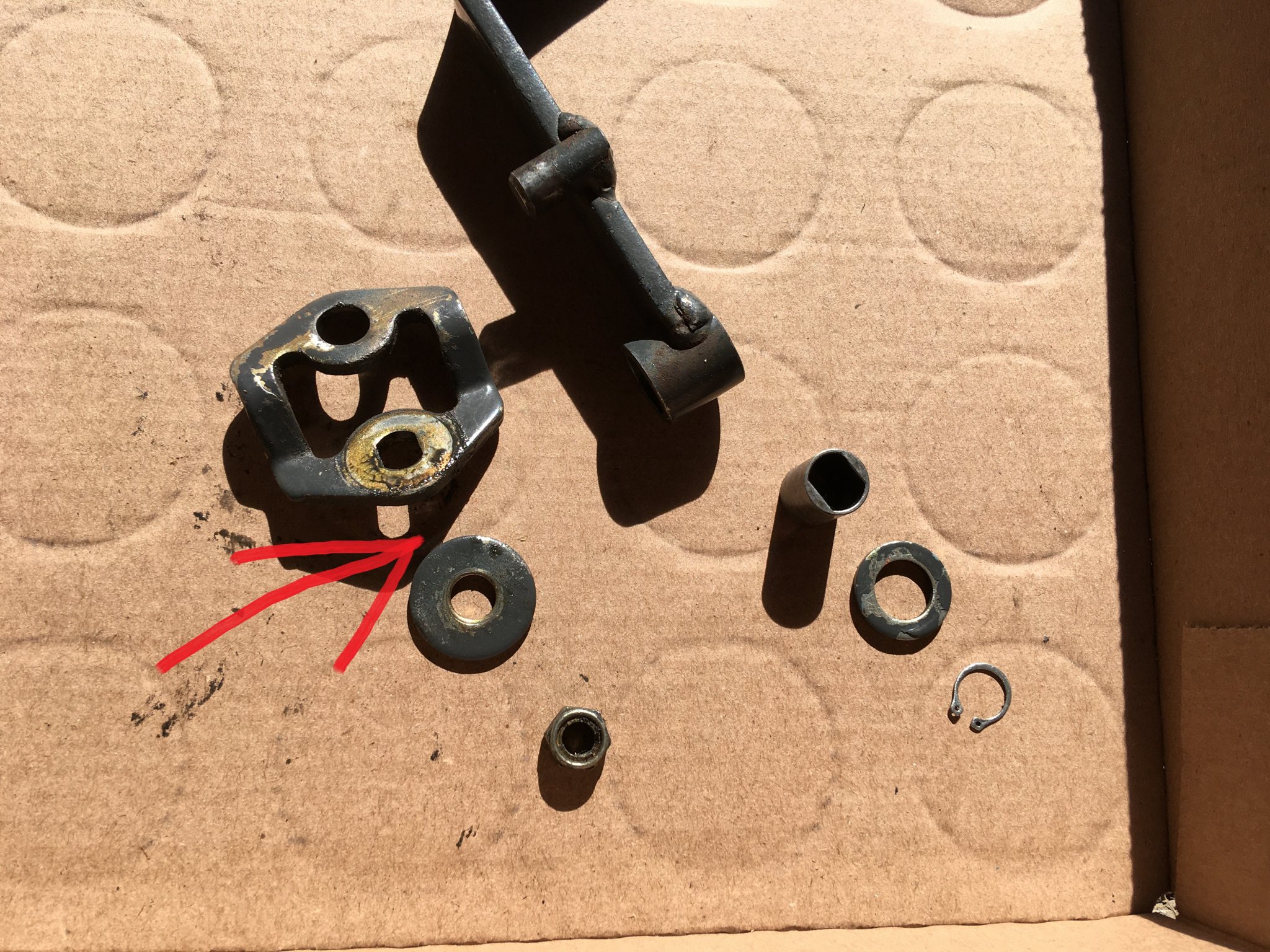

I did have the lever off and someone before me also so I don't know exactly what should be there. The photos show what I have. I have read about the adjustable lever stop and I do not see one here so this is among the missing also. I also don't see anywhere an oring would be placed other than inside the cylinder case. I do feel though that there is a lot of thread left on the circled shaft and something would be there for friction. I will get a few conical washers and replace the make shift plastic washer in the near future.
I have shown in the photos where I placed the friction.

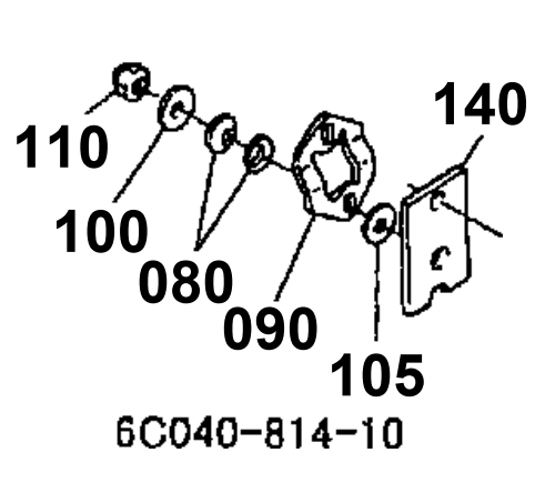

Here is a screen capture of your version of the control arm bracket from the B2400 parts manual page 104, and these parts are represented in your photo IMG_8148, but note that the two parts number 080 are missing. Those are the conical (cup) washers that should be keeping the arm control lever (090) from moving. As you suggested, they should be located on this shaft and would be placed under the washer in your photo, between it and the arm control lever. Adding these two washer to this assembly will fix your problem.
Part 105 listed as a collar was also missing but unavailable so I replaced it with a regular washer to keep the nut from bottoming out on the shoulder of the shaft. Installed the 2 spring washers and the lever no longer falls. Thank you all for the help.
