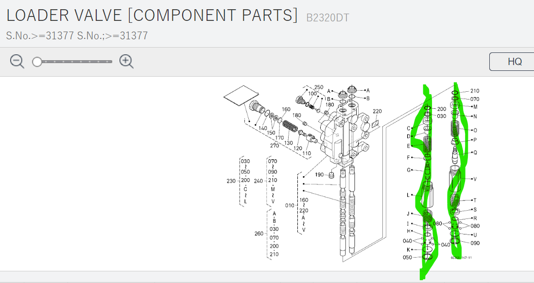

The only balls and springs are in the detent, and the odds of them needing lubed are rare.
But here it is:
33,466
8,745
You could try lubing these parts and see what that does for you.
