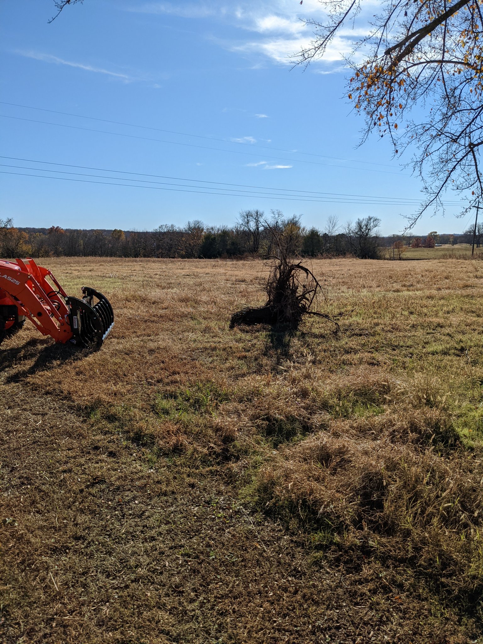

I just pulled a 10" stump out with my L2501. It barely got it out. It's just not heavy enough. I wouldn't buy an 2501 and think you're going to be pulling large stumps all day.

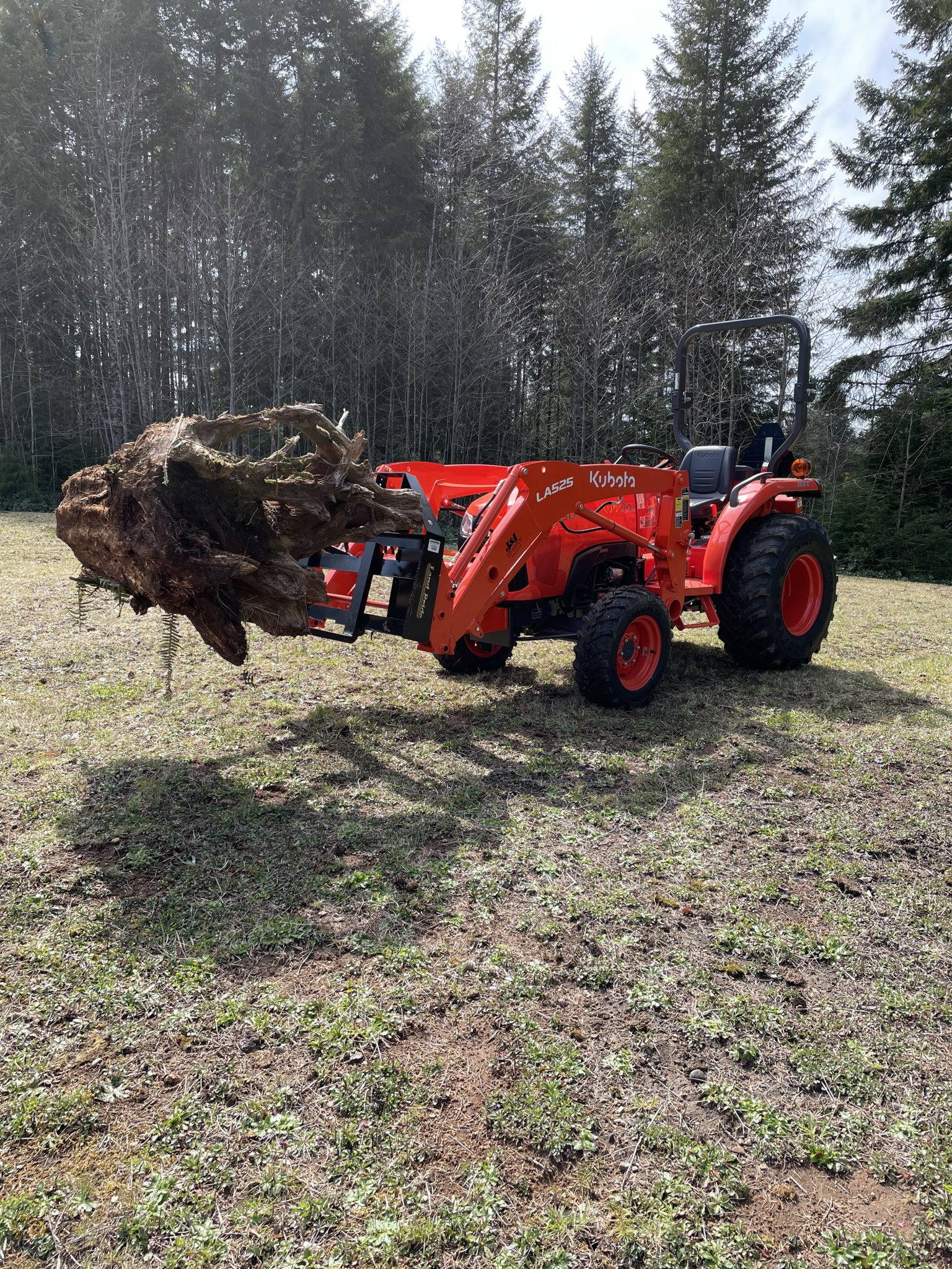

My B2601 just wasn’t capable of pulling stumps on my property. The L2501 has done everything I’ve asked of it. That being said, the Grand L / MX may have been a better choice but at a much higher price.

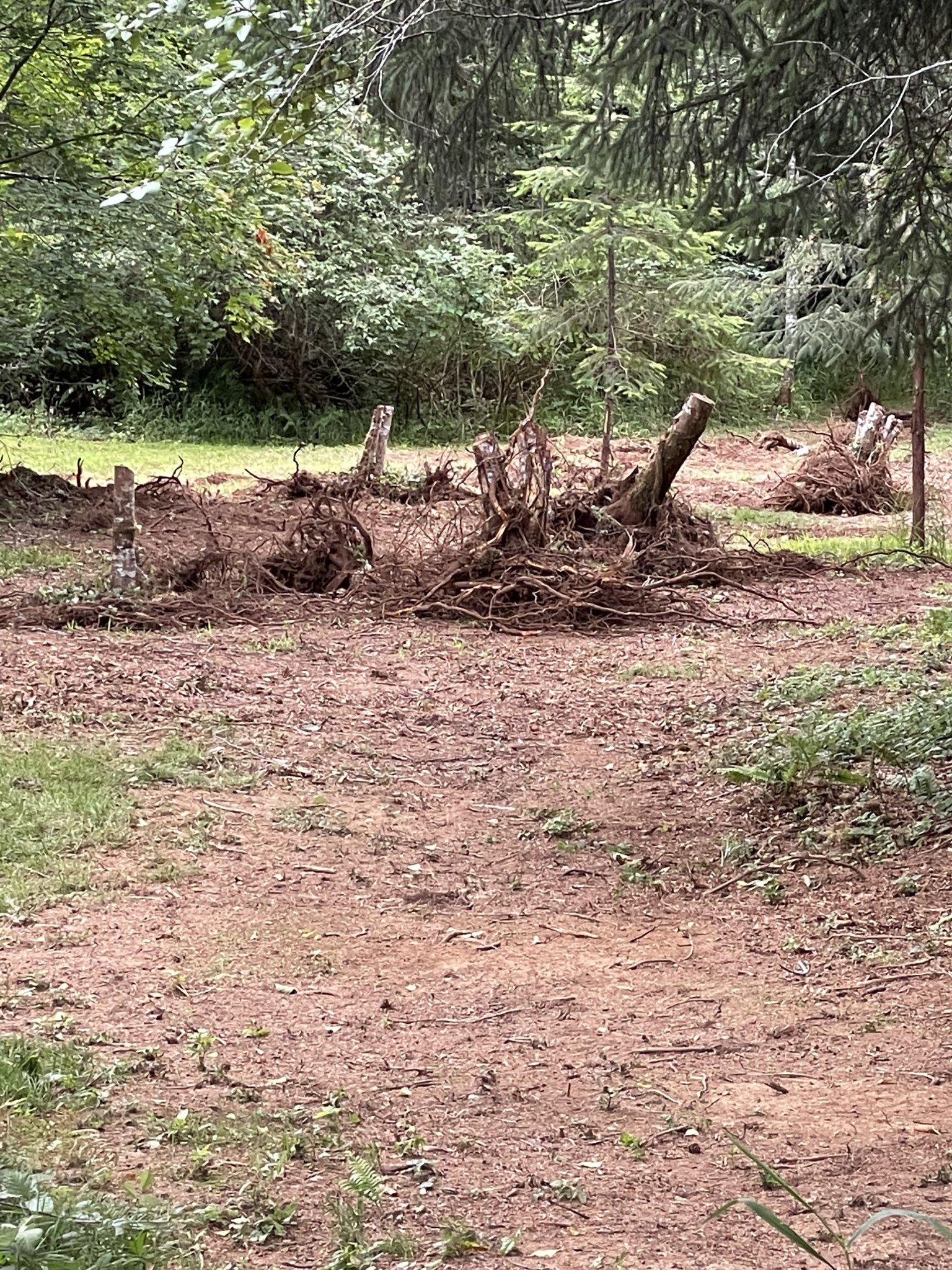

I second this. i've pulled out large stumps with an l2501 and bh77 . might take some creativity, but it works. i imagine the lx with the bh77 couldnt have done it. now that the stumps are gone, i had been considering an lx for the cab. also consider an excavator rental for the stump job, if its a one and done.

And I've pulled large stumps out with my B2650/BH77 combo, too. It's mostly technique, that "creativity", when the stumps are getting the size that the tractor can barely handle.

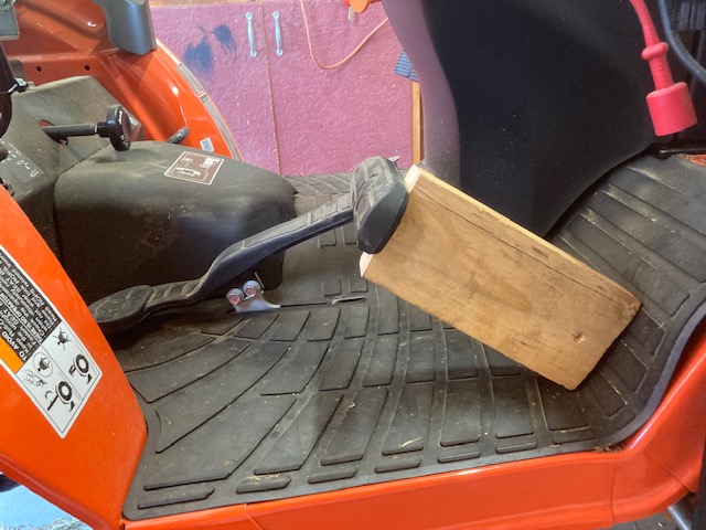

My B2601 treadle is smooth in forward. I found the reverse stiff and awkward because you have to find it and stomp straight down with your heel, which feels unnatural. I guess you can put your toes under the forward treadle and lift, but that felt even worse to me.
After 8 months, I think I'm pretty used to reverse, however. I did chock the treadle pedal occasionally trying to weaken the reverse spring. Doubt it worked because it is a very stiff, powerful spring. There are other fixes like replacing the spring, but I couldn't figure those out. Dealers seem to be no help on this issue, saying it will break in fine.
You should try the B2301 and see how it feels. Kubota has a number of treadle variations. The B2301's is probably the same as the B2601 but may feel different. It also may or may not bother you. I figured I'd get used to the pedal and, like I said, seem to be adjusting and don't notice it so much. I think my body has gotten used to how it feels and what needs to be done.
