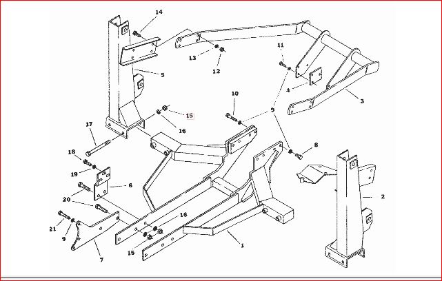

Maybe I'm off on what I think but I'm about 50% sure (and falling by the min) the sub-frame of the b219 mount to the side of the bell housing or better know as the Clutch Housing Frame on that model, and not to the motors frame or side of the motor, on the other hand the B1630C's sub-frame does mount up that way.
B7100 HST Clutch Housing
B219 Sub-Frame
B1630C Sub-Frame

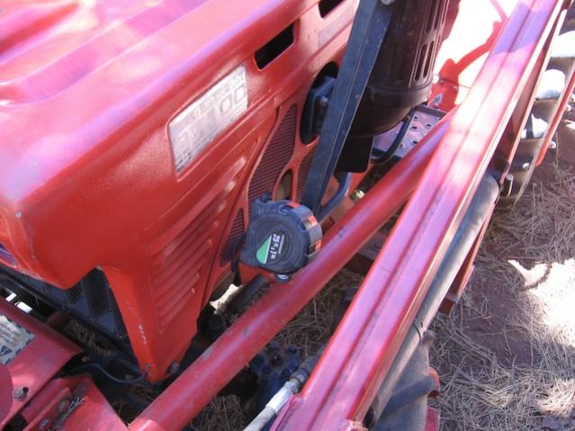

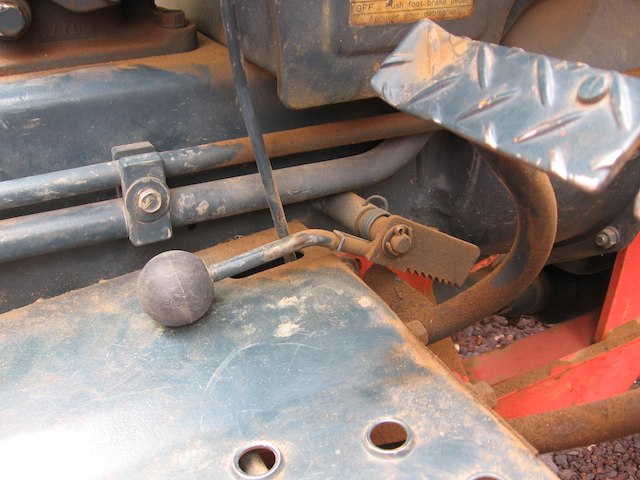

I'd take some more definitive pics, but my tractor is 150 mi from here. These are pics I had showing other things, but they might shed some light on the subject at hand. Mine is a B7100 gear.

I have a early eighties (4 bolt front wheels) B7100 HST. It does not have any mounts on the side of the clutch housing. I was surprised to see the parts diagram that you provided that clearly shows the clutch housing mounts. A quick visit to the Kubota parts website cleared up the confusion. What they list as B7100 HST-D New Type has the side mounts. What they list as B7100-D Old Type does not have the clutch housing mounts(like my tractor).
