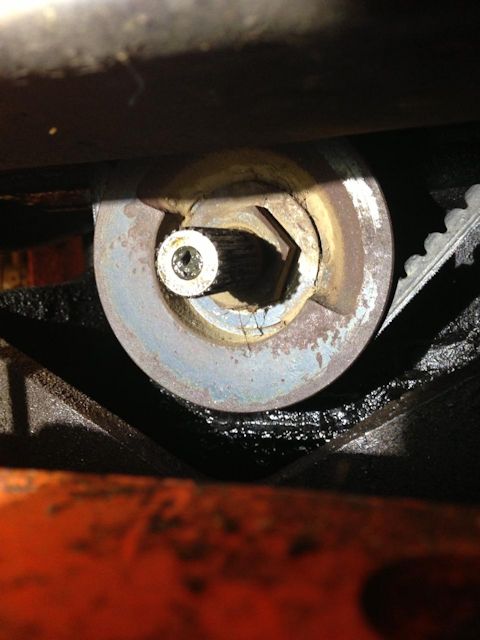

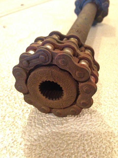

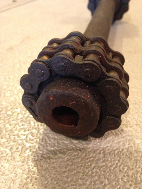

Here is what it is:
Swapping the pump would be easy if it was not for the 9/16 shaft size, that size is obsolete, either 1/2 or greater, and most 1/2" size pumps ane too low of a flow rate any way.
The chain sprocket coupler is welded to the shaft so just swapping it out for a lovejoy coupler is a pain, I'm thinking the best option is to mill the keyed end out from the 9/16 hole and 1/8'th keyway to the 5/8 and 5/32 keyway
This pump: 5.28GPM
http://www.baileynet.com/product/10638
Should make it run fast, and strong without too much load on the engine.

Okay, I gotta ask, what exactly does that chain drive? It's 360° around the sprocket!
If that's just a transfer shaft from the splined crank front to the key'd pump shaft, then yeah, just bore and re-key the shaft.
What do those chains and sprockets accomplish?

The chain coupling joints are torque joints it keeps the pump from ever being solidly connected to the engine, allows for some "give".
The chain joints consist of 2 separate sprockets and a double roller chain that connects the 2 sprockets together.

The chain is a standard size it is # 40 double roller. I replaced one last year on one of my tractors. It is the sprockets that are special the mating faces are machined. One cupped in, the other extending out to help keep the centers aligned. Have the sprocket bored out and a keyway broached in. Not a hard job for a machine shop. 6 gpm is about correct for the size,
