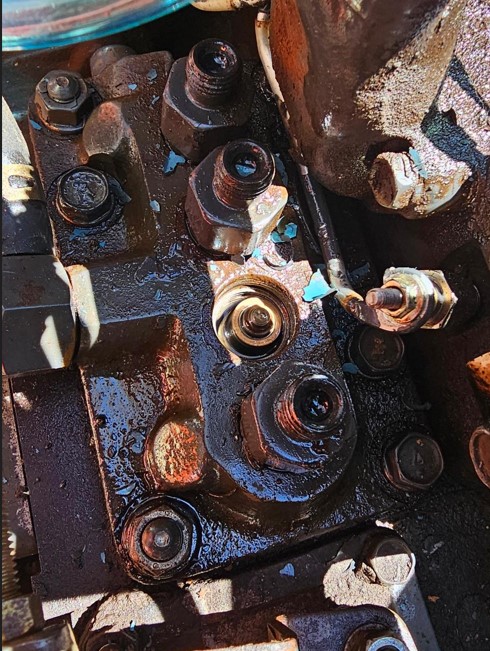

Today's discoveries...
While bleeding the lines to the injectors as advised...three lines bled out a little air, was getting excited, then...one line was loose at the pump end. Removed the loose fitting and the o-ring is cracked/broken. Might as well replace all 4, and the copper washer as well. (one-time use parts)
I am open to any advice for things to check before re-assembly, tips and tricks. Torque value for the delivery valve holder, Item 1?
Thanks to all in advance!

I've never found a listed torque valve for the delivery valve holders.
Really you're supposed to have them rebuilt when you have issues like you are.
I just go snug and a little more.
