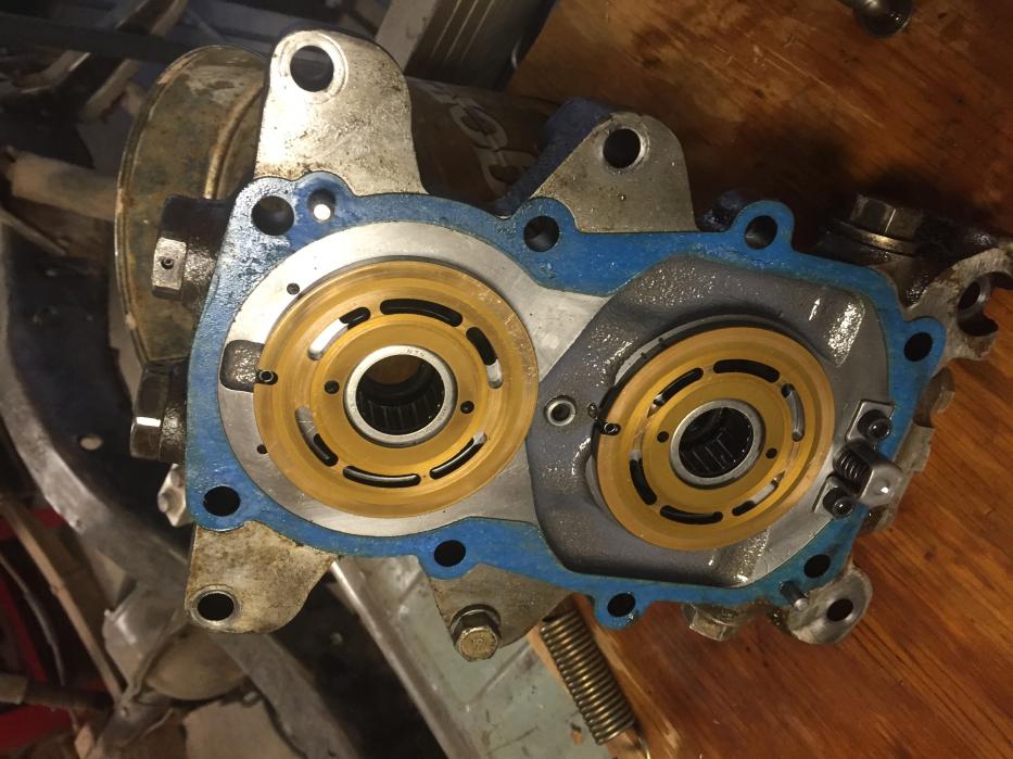

Did you ever figure out why the dowel pin broke (Post #11) that registers the pump's seal plate to the housing? When I first read that I remember wondering what condition could put enough force on it to shear it.
Did you take any pics of the back ends of the pump & motor showing the surfaces that run on the valve plates? How did you clean up the gouged area around the failed pin?
Are the valve plates the same? Can they be mounted either way up? (sorry if dumb questions)
I'm betting you're going to solve this without spending big money. If the valve plates (and maybe the pump and motor housings) need to loose a few thousandths to be flat again, I'd do that and either shim the stack or machine the same amount off the housing so it goes back together right. With the contact surfaces trued up the oil film between them will then hold the pressure. Take care, Dick B

rbareron I tried to come up with the test fittings from the link you posted, but figured out Kubota uses a deep probe type fitting to test the hst as shown in the wsm. I was told that using standard size fittings would not provide a accurate reading so then I just decided to take it to the dealer for testing.
As far as the broken dowel pin, I think it was do to stress, and that was the weakest link. from starting in extreme cold and I think it had water in the system, not for sure but just speculating.
the valve plates are different between pump and motor, taking any material off the plates would loose all sealing capabilities, I don't see how you could shim the stack to make up the difference, I don't know, Ill enclose some pics maybe it will make more since to you.
I would just replace the valve plates, for about 700.00 but may not solve the issue, could be loosing pressure through the piston assymblys too.
Im just thinking a used hst that works may be the best option on that part.

Nothing jumps out at me in the pics. With the pump's locating pin reinstated I'd have expected it to work. Wonder if it's broken again? Something is preventing the pump from making pressure.
I'm not much help - the only HST I've worked on is pretty different. My issue was weak reverse but yours is both directions.
The test results the dealer wrote are hard for me to follow - they wouldn't make any sense for my HST because it has its own charge pump inside. Actually the fact that the testing dealer had to make a second attempt indicates they may not have much HST experience. I have found that HST knowledge in service departments can be low. HST's rarely fail so few ever work on them. The factory tends to recommend replacing the HST whole if basic function isn't right - they don't even want failed ones shipped back.
Does you WSM have troubleshooting on the priority valve, etc?

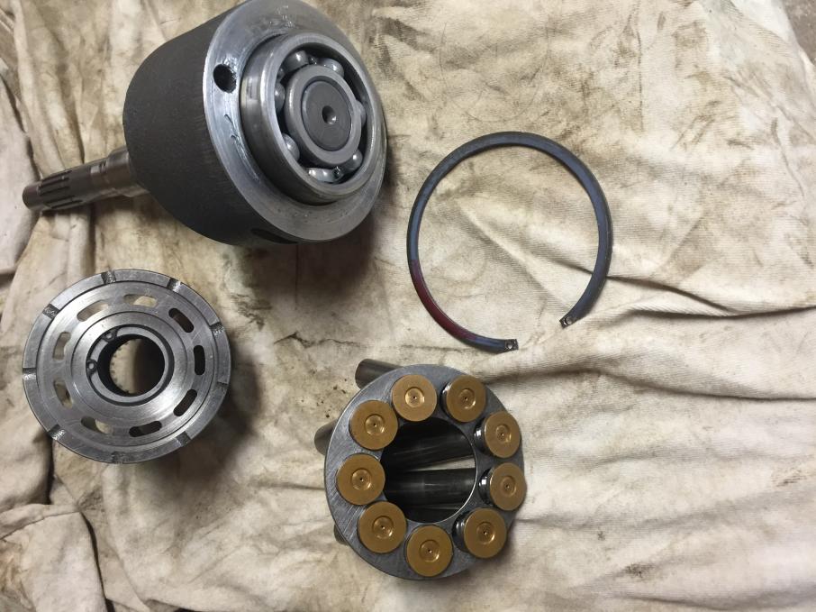

well shortly after my last post I got on the internet and called every tractor salvage yard in the country looking for a used hst, and not having much luck, then called an outfit in Riverdale, Ca. and he said no, but would put it on the hot line, then called me back 30 minutes later and said he found one in the LA area, so I purchased it vie credit card and had it shipped out here to Colorado and arrived on my door step this morning.
I am happy to report that I finally put the "mighty" back in "mighty mouse".
It took about 45 minutes to split it this time, since it was already partially dissembled, put the new to me pump on and pre filled it, and fired it up and babied it around a bit before going full bore, and it literately feels like it wants to climb a tree. I know you guys probably heard that expression before but that's what it feels like after running a tractor that's lost its mobility.
I also spit the old hst pump open, and everything still in tact but as little running time it had on it, the valve plates already had discoloring and burn marks, so I may take a crack at rebuilding it again when I can get over the pain and build up the funds again after spending 1700 bucks on this used one.

Good outcome. Glad mighty mouse is running strong again.
The old hst is a head scratcher. They depend on a high level of accuracy and precision that's expensive to restore once disrupted. For the handful that fail, Kubota advocates junking them. Hard on the customer's checkbook, but maybe less pain overall. Good luck with the replacement - Dick B
