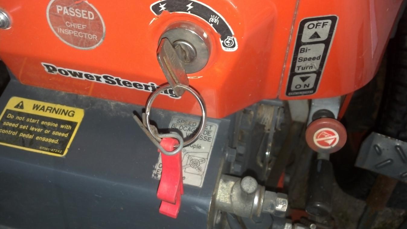

I just went out and was looking it over again and realized, I'm not 100% sure on the glow plug operation. Is it key left and hold like on my B7100? If so, the switch appears to be bad because it does not automatically return to center. Assuming center/vertical is where it should be for "off", and just right for "run", then full right (which does return) for start. Is this correct?
The thing that made me question is the key fails to return from full left, AND there is a momentary button on the left opposite the key. No sticker or anything, but I was thinking maybe that was the glow plugs, or maybe horn (if so, doesn't work).
And speaking of controls, what is with the light switch. Rotary knob for the lights seems straight forward, and you can make out the icons, which helps. But there is a lever underneath. Is that a turn signal? Appears to have 3 positions at forward (right), horizontal left, and rear (left?).
Sorry for the ignorant questions, but with no legible stickers and no manual, plus the PO apparently only used it rarely and for loader work, I'm at a loss.

The Single Lever Loader Control Is Standard. If Working Correctly Its Much Nicer Than 2 Sticks.
The Double Gated Shifter Is Transmission. The Heel Pedal Is Diff Lock. The Bent Shifter On The Left Is 4X4, Up Is On. The Foward Pointed Lever On Left Is pto Up And Down Are 2 Dofferent Speeds Center Is Off.Key Switch Is Accesory, Off, Run, Glow Plig, Start. Light Should Light Up In Dash While Glow Plugs Are Operating. 10 Seconds In Summer 30 In Winter.
