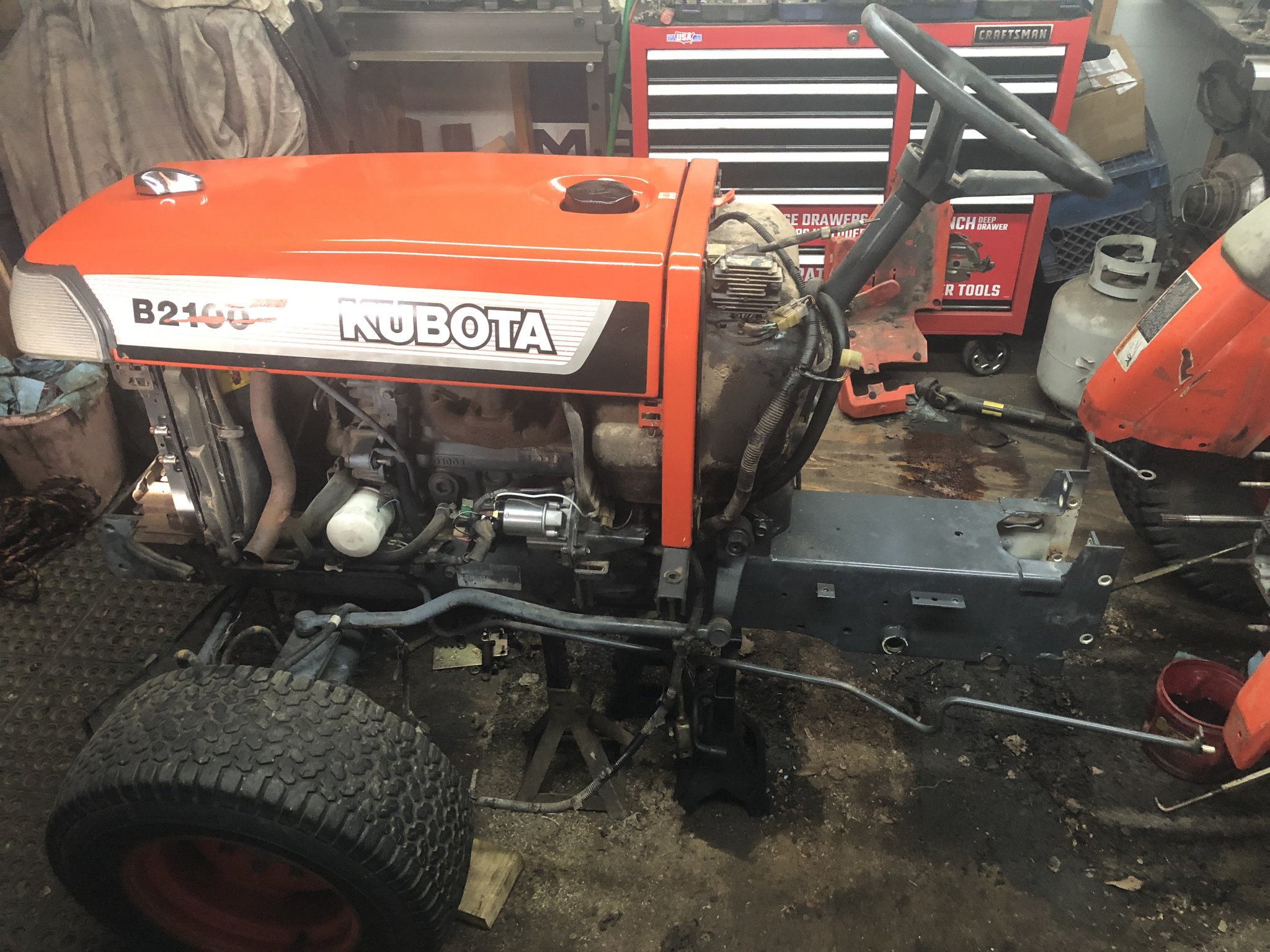

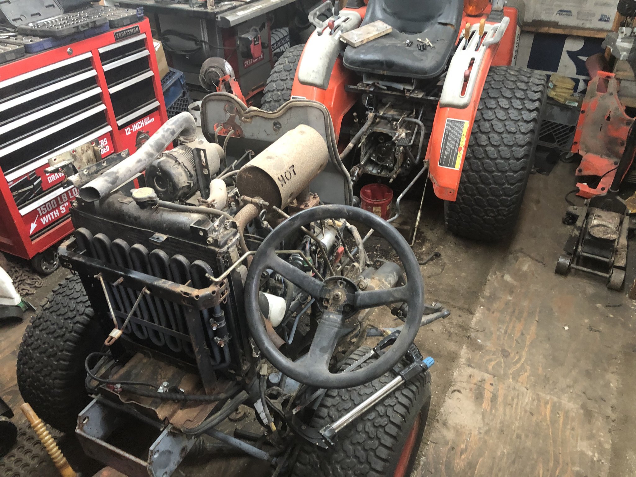

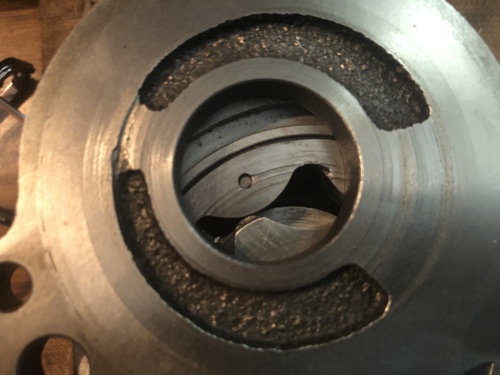

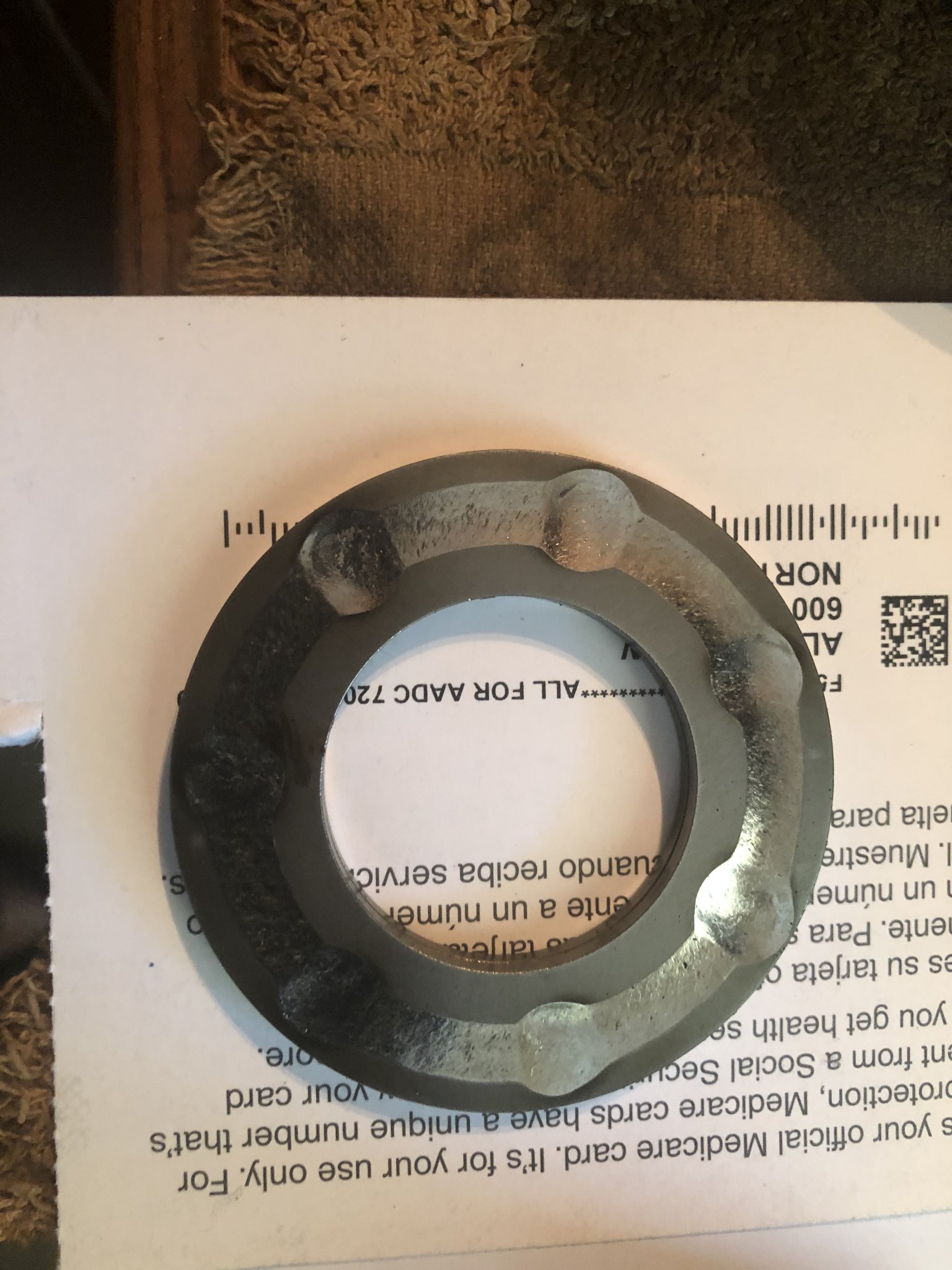

Hello, just joined, not new to wrenching, but deff new to wrenching on tractors !. picked this little gem up a few days ago, engine runs strong, tires in great shape, but the hydro tranny was trashed ( as i tore it down..was expecting this ), never tore into a tractor until this one, been wrenching on atvs , motorcycles, small engines for 30 yrs, not affraid to wrench. this is a whole new ball game to me, but its fun !. here is a few pic's i took when i split it, and one pic of the front end going back together. waiting on hydro tranny parts to come in, so i can put the hyrdo back together, get the tractor back together. i have more pics to post showing the damage to the hydro if anyone is interested in seeing how the PO destroyed this tractor.

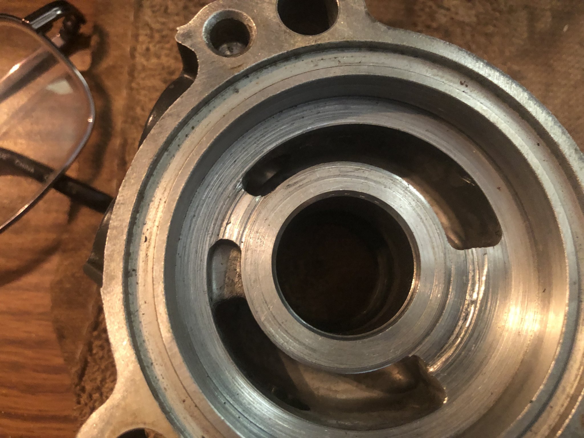

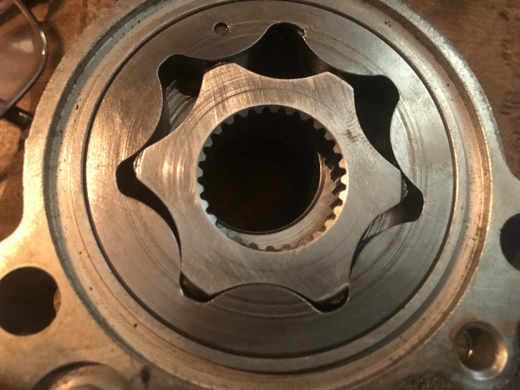

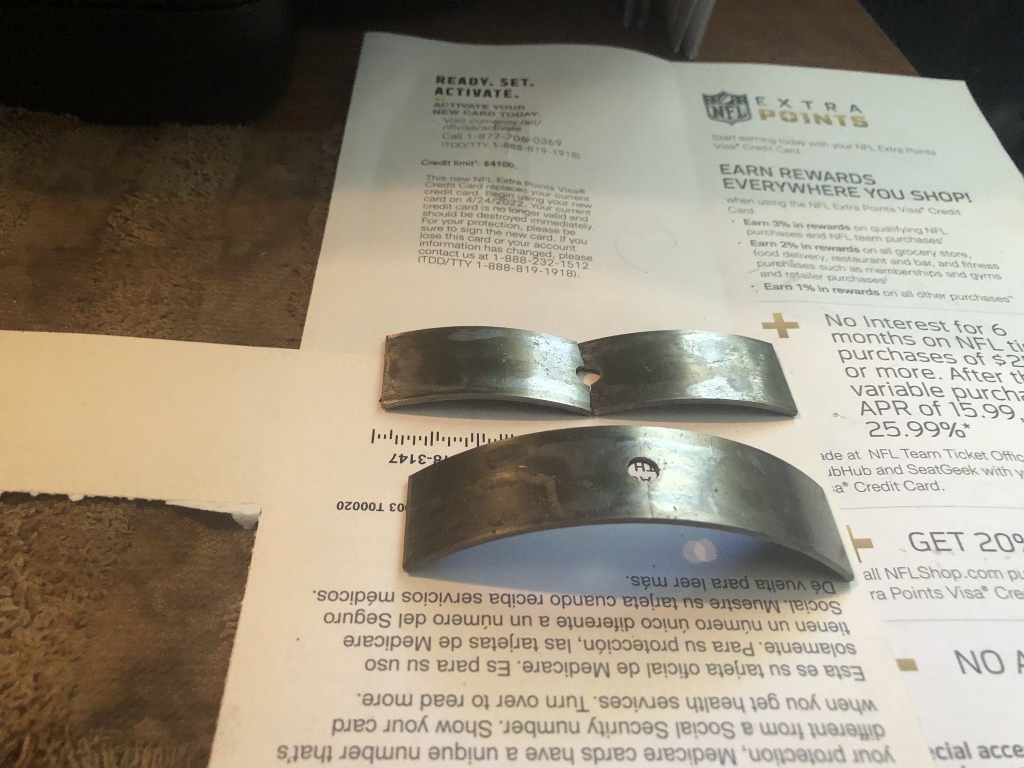

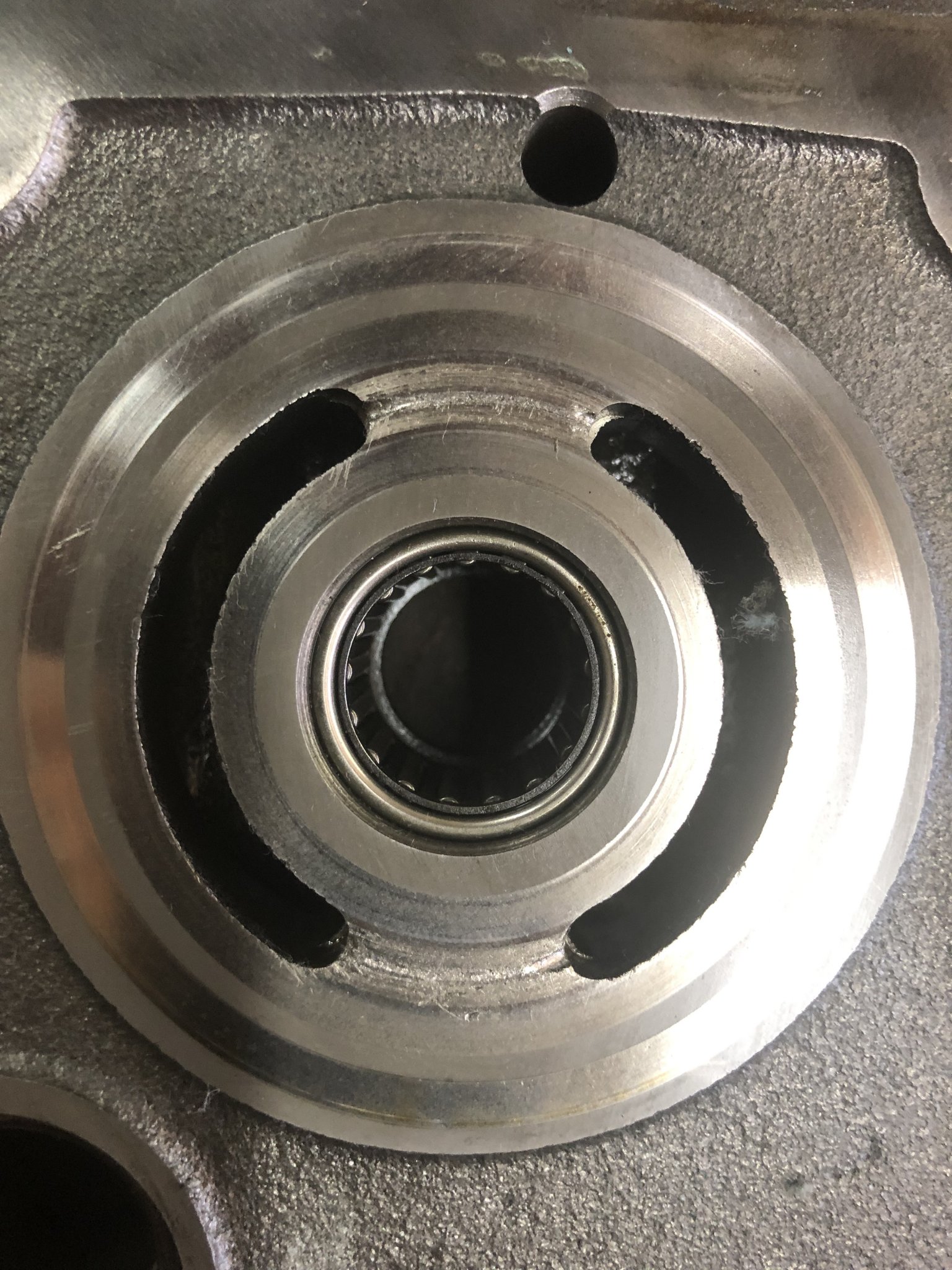

i am not sure what caused this damage ?, but what i discovered when i pulled the cylinder pumps apart, one of the springs that those chrome piston things use to push it up was broken inside the piston, and from the looks of things ?, it seems to me, this spring got chewed all to heck while going through the hyrdo area ?, this is my thinking anyway. there was hardly any hydro fluid in this, when i got it home, not sure if it had a leak or what ?, maybe ran it dry..over heated the pumps ?, no clue !. but what i do know is, PARTS ARE NOT CHEAP !..LOL. when i pulled the fluid filter off the right rear side pipe, it was clogged big time !. and when i drained the hydro oil, it was full of metal shavings big time. i knew right then..the hydro tranny was shot, and here i am..waiting on some high dollar parts to put it back together, and saying a few prayers hoping it will move again on its own power ?!..lol.

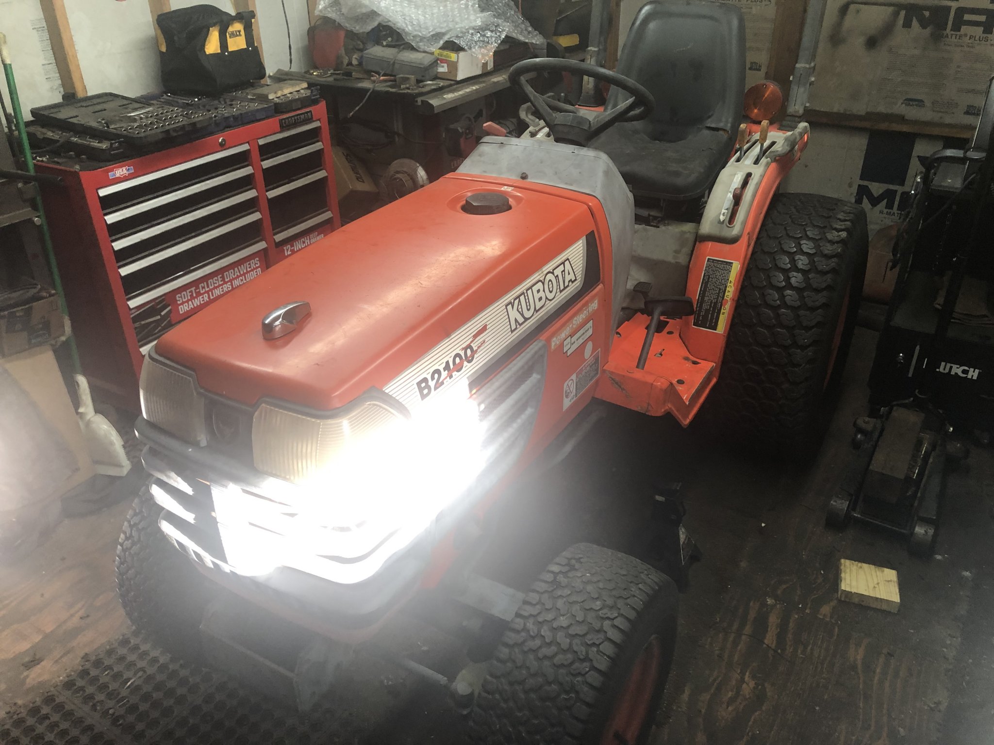

update; just a short word on the progress on this restoration, got the hydro all back together with new parts, added hydro oil, fired her up, SHE LIVES AGAIN !. on a side note..lord help anyone who attempts to tear out the hydro drive tranny ?!. it sucks trying to get it back together big time !. i never...EVER..want to do this again for the rest of my life. once i get it all back together, i'll post some pics in this thread.

here she is so far, runs great now. got the 3-point hitch installed, that works as well. jus need to get the floor mat back down, or may try to fab me a new floor mat up ?, seems pretty simple. not going to buy a new mat, not when i had to purchased two brake rod set-ups for both sides, they are bad, wont adjust, snapped one trying to unscrew it, kubota is pround of their products even when they are 20 something yrs old !..lol.

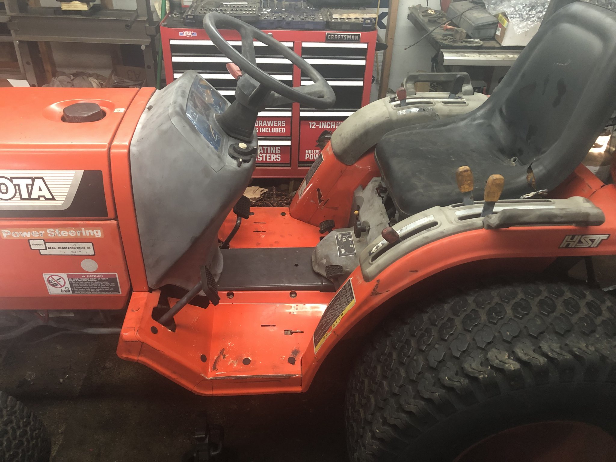

finally got a chance to crank her up, under her own power, drive her out of my shop on her own power !. got out in my yard, seen i had forgot to hook the rpm cable back up ?..grrr..lol whoever designed the dash on this model needs to be slapped !, its one royal pain in the rear to get the dash off..and back on. anyway, got all that done, and i'm happy to report..she's done for now !. when the brake rods come in, i'll tackle replacing those, but for now, i do have brakes from the right hand side, will leave it alone until the new parts come in. anyway, i am a happy camper right now !.
