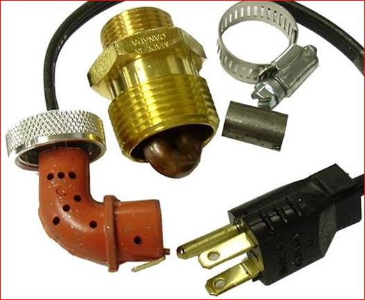

The block heater you want is:
P/N 70000-73274 $47.77
http://www.colemanequip.com/Parts_Detail.asp?partID=16523
It's a screw in model (there will be a plug in the engine that will need to be removed), some have it on the right side below the injection pump and some middle engine on the left side.
most of the plugs that I have seen have had a 17mm Allen wrench style plug.

See Ultimate READ ME at top of this forum to find links to install threads of this and other type of freeze plug heaters
