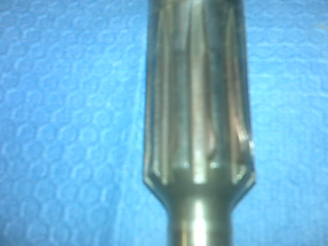

Great site...Actually inspired me to tackle the replacement of the clutch in my B21 (well, the $3000 quote I got my a local dealer kinda helped also). I have to say I was heart broken when it failed, understand that this tractor would be parked in my living room if my wife would let me! 2004, with 850 hours (I've owned her for the last 200 hours or so). The dealer had never heard of similar failures and were blown away by the wear on the shaft. A smooth notch almost in each of the splines that tapered out towards the other side, eventually taking out all the splines on the clutch disk (all other components were in excellent shape, although I still replaced everything). Before it failed, I was in high gear, not under load when it started to make a grinding noise. I stopped, geared down, proceeded to move forward when it finally blew out the splines on the disk.

Thanks for the insight Vic. Seems my # (62639) does not have the same input shaft support as part # 32721-12100. Avenue said there was a number of repeated replacements and service bullitens on this issue for and my machine was the 2nd to last series by serial #'s.
Thought I'd throw in a little pic of what the worn clutch shaft looked like for anyone else that may come across this issue, the pics a little blury, but you can see how the wear tapers.
As I mentioned in my previous post I had a heck of a time bolting in the oil line to the gear box after rejoining, so when i realized that I had an oil leak due to a couple of missing o rings on a particular "oil line flange", I decided to cut myself a little 4x4" access hole on the front top of the center frame -figured this was acceptable as I'm just a farm kid :). Is there any way to test that bearing on the tranny input shaft without splitting? I did notice that there is forward/ back play in the propeller shaft (maybe 1/4" tops).
